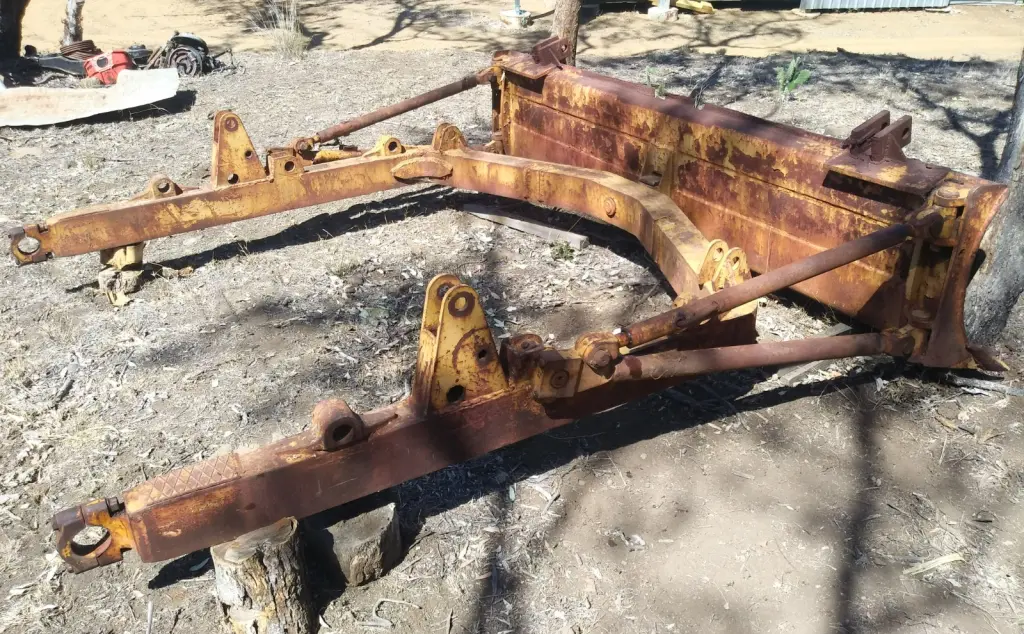

This blade came with my D4 7U but I believe it isn't original to that type of tractor.
[list]
[*]the C frame is very heavily built
[*]the mould board is a little over 3m wide
[*]the width at the trunnion caps is right to fit my 7U
[*]if it had a serial number I can't locate it (possibly underneath one of the the stick rake mount plates?)
[*]seems to have mounts (that have been cut off) to suit rams on the nose of a tractor
[*]the brackets for rams attached to the track frames appear to be a later addition

Thats a D4C or D4D set up with some modified braces welded on.
Hi, ROME K/G.
The D4C had the blade lift arrangement mounted on the outside of the track frames like the U series and earlier and the lift points on the C-frame would have been just behind the middle angle brace points on the sides of the C-frame.
It does appear that something has been cut off the front of the C-frame on the back face of it either side of center, which would be consistent with a D4D with the lift rams mounted on the hard nose.
Hi, Haus.
If you are lucky, there could be a serial number stamped into the BACK of the blade below the rake mount on the right side. You may need to scratch some rust or paint off to find it.
