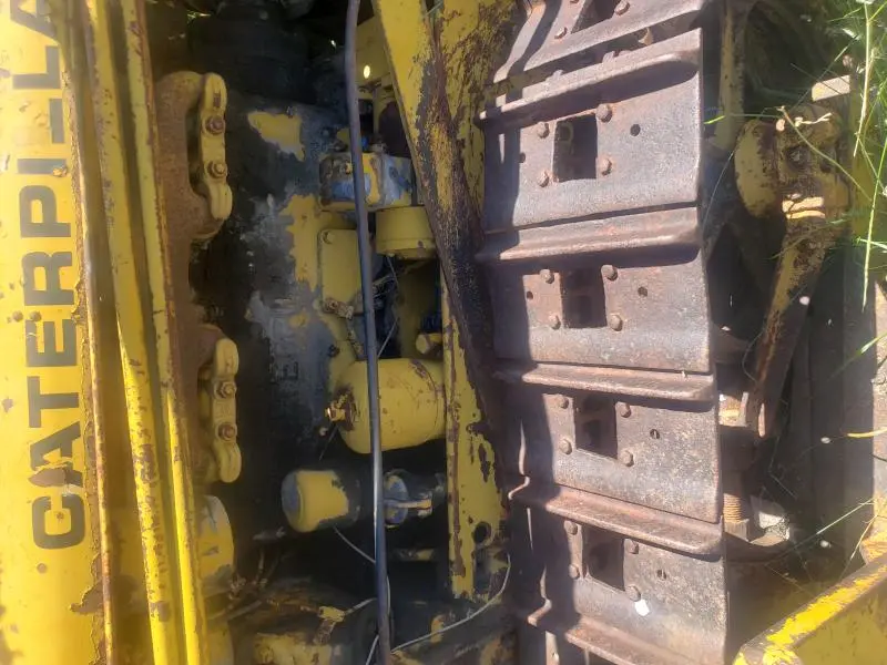

Thanks for help guys. It appears to be an old military tractor judging by the tank. It was backed up over a 2" steel spike and it took the left track off the sprocket and up through the pads. ZERO oil shows on the stick and I think it is stuck Pony turns but with no evidence of compression. I has sat in the Id[attachment=59443]20200622_114319.jpg[/attachment]aho snow for at least 25 years. I will post a picture of the 4" square holes cut in each pad. Why would anyone do that?

Those are snow relief holes to allow the packed ice and snow to be pushed out of the links so that it doesn't bind up the tracks when operating. Common thing to see in snowy climates.

Looks like a 4U
