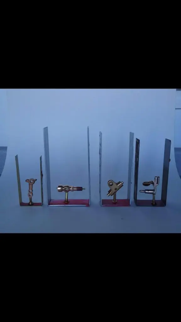

Hi all, I just got this picture from a fellow I discovered here in town. He has agreed to cast a few parts for me. His mainstay is casting miniature lamps and miniature artwork for high end doll houses. Google Jim Pounder to see examples of his work.
I took him a primer cup, a throttle arm from a Schebler D carb, and a piece from my Holt 45 throttle linkage. Compared to what he normally does these are “easy” for him.
In the picture he has polished the parts up in preparation to mold them in Silicone, he uses the lost wax method, and has a centrifugal foundry. Once the silicone molds are made he can use them over and over. I’m anxious to see how the primer cups turn out, it looks to me like the machine work will be minimal. I’ll keep you posted.
Bruce P.
[attachment=47490]27F7D6D2-E075-41EA-999A-2D0A4DB208FB.jpg[/attachment]

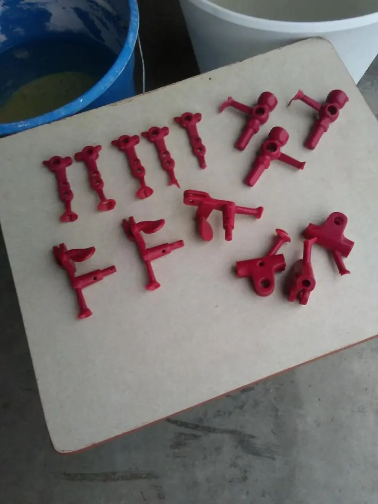

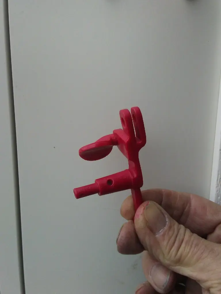

Just got these pictures of the wax molds. Looks good to me!!
Fingers crossed
BP.
[attachment=47555]D4A43965-D432-4D5D-8082-E0F7929E72C9.jpg[/attachment][attachment=47556]53DC788A-1B38-4AED-942F-70C9A7368842.jpeg[/attachment]
Fingers crossed
BP.
awesome just goes to show you get the right guy for the job. things get a hole lot easier. thanks for keep up posted.
