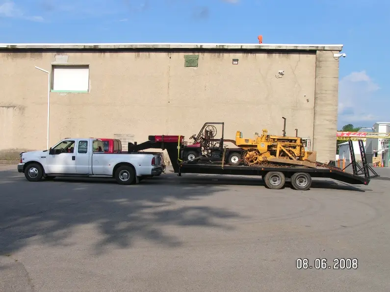

Opps....;o
Wide 1946 D4 5t. Had to use beams to lift the trailer frame. Very close on the trailer fenders.
Winch, come-a-long and two hi-lifts got her on. Yes slightly over loaded but I had less than 10 miles to move. Would not do this over any busy roads.
I already had the trailer hauling hay and boulders or the weekend.
The next option was pay $200 for a roll off.
I hauled my D2 5j with a blade on a Penske flat bed rental. That haul was over 500 mi. Plus I had two extra sets of tracks.
