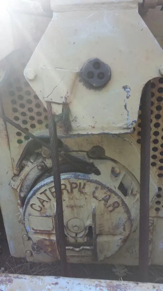

Hello I have a D6 4R runs great or at least used too. Just lately it has been loosing power to the small piles of brush, like it is really weak. This machine starts up and runs like a champ everyday. My neighbor said its the harmonic balancer up in front is messed up/ going out and that can mess with the engine. thanks for all info! here's a pick of the cable center up in front. [attachment=22141]rps20140314_185610.jpg[/attachment]

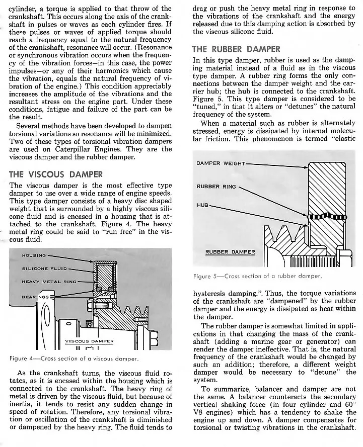

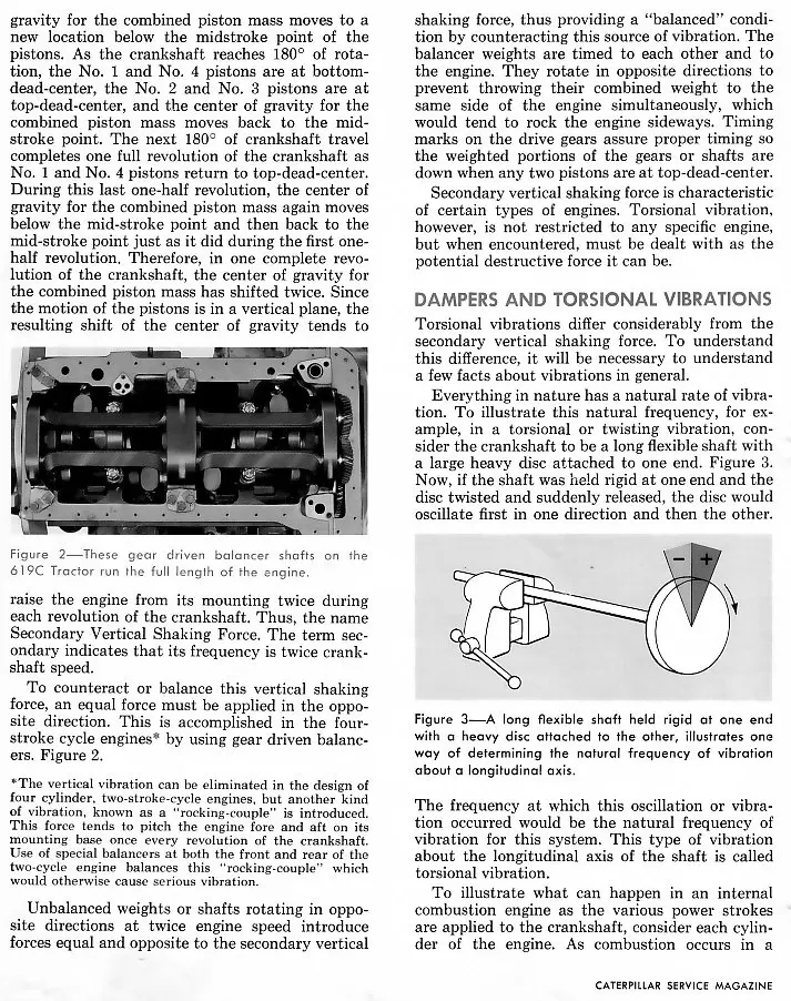

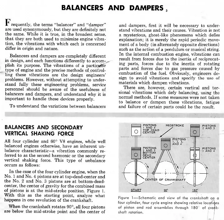

Hi Team,
from a Service Magazine dated May 15 1967. The article is on this very subject.
It is a bit in-depth to start with but goes on thru the differences--the Harmonic Vibration Damper is discussed later in the article.
Hope this helps.
PS looks like we are back to the BB posting out of order again.
The pix are numbered for ID sequence :- 1 thru 3--sorry.
Mon, Mar 17, 2014 6:59 AM
