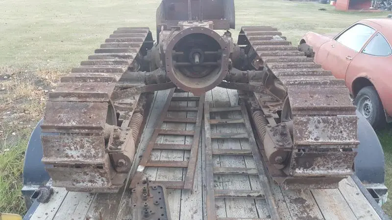

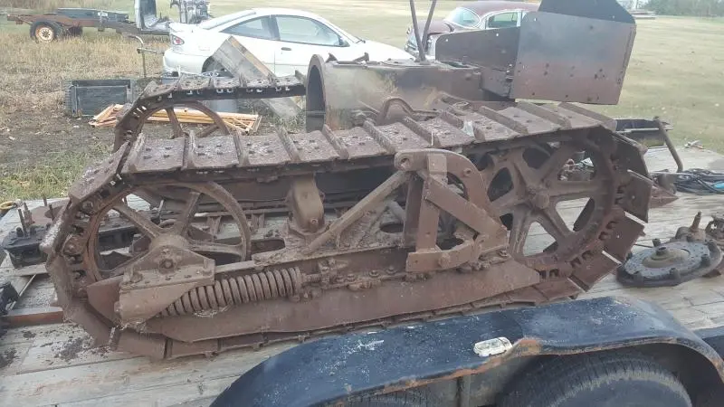

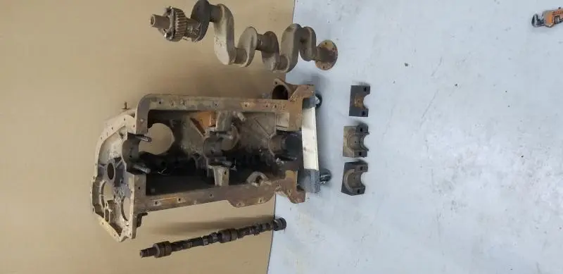

Hello everyone new the the group. I picked up a 1937 twenty two 1J1227WSP that the motor had been removed and disassembled about 10 to 20 years ago parked in a shed and forgoten about. Was told it had been in a fire at some point the son knew very little about it. Was only a mile from my acerage so made for a quick trip home Nathan came out to help load it up. I have started tearing down rest of motor and cleaning part found a couple little problem that should be fixable.

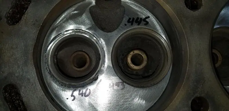

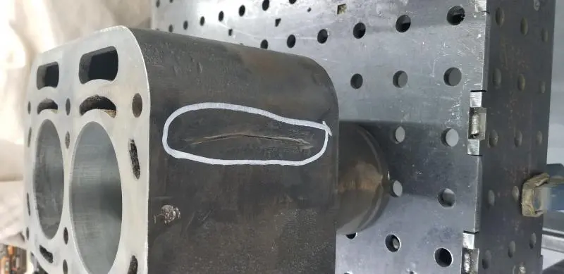

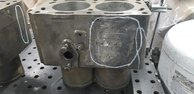

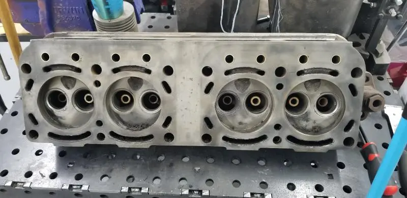

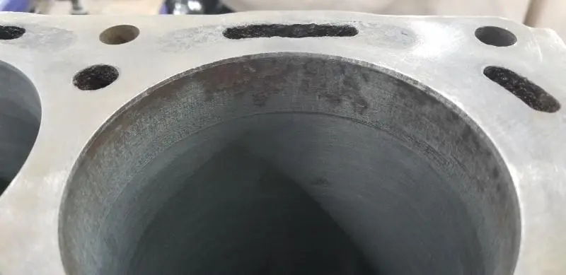

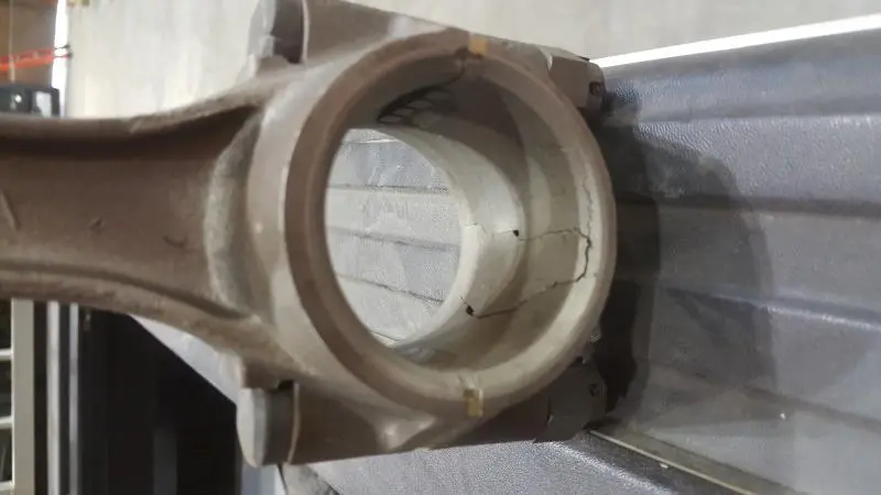

Some issues that I have come across so far.
1. Connecting rod big end bearing need to be repoured on 2 rods.
2. 2 cracks and a big patch in he cylinder jugs will need to be welded. Thinking about tig welding with stainless filler rod.
3. Cam has a worn lobe (very pointy others are nice and round.
4. Exhaust guides and seats need replacing.
5. Some minor pitting and ring ridge on cylinders. Maybe new pistons and rebore or just run new rings i have. 015 to .020 piston to cylinder clearance.
[attachment=46777]20180125_220118.jpg[/attachment][attachment=46778]20180125_191729.jpg[/attachment][attachment=46779]20170922_114947.jpg[/attachment][attachment=46780]20180125_191820.jpg[/attachment]
Anyone have sources for new parts or usable ones.

Is it normal for the exhaust valve to be bigger at the bottom of the guide all 4 are the same goes back to nominal size about 1" down.
Sun, Feb 4, 2018 8:22 AM
