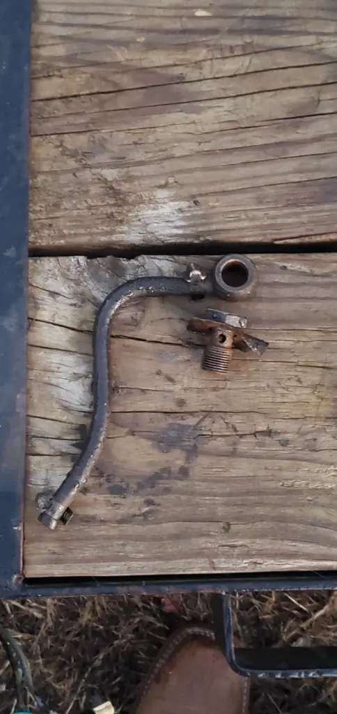

 [attachment=71017]20230117_065705.jpg[/attachment]    I'm close to having all the parts to put my machine back together. I'm needing grease tube 1h6752 for the steering clutch controls. Both were missing when i disassembled.. I've located the bolt but the tube is another story. Internet shows it fits several machines bur no luck finding them. Any ideas where to locate them will sure be appreciated.  Thanks

well thats a banjo fitting and hose
easily purchased at any hose and fitting joint.

Thanks for responding. I only found one site online and they were out of stock. I knew it looked like a banjo fitting but since it is a grease fitting, I thought it was a specialty fitting. Thanks again.

originally it might have been a bit of copper tube on that banjo fitting rather than rubber hose check the other side and see what it looks like, easily made up if you can solder.

I did these on my D4 steering clutches, as my hoses where falling apart too, so I took them to a hydraulic hose repair and they made up new hoses crimped to my fittings.
Trainkid88 they have tobe flexible as they mount on moving parts on the steering clutch release bearings,

i didnt know they were hose to be flexible. yes get proper grease hose. is yours grease lubed ours is oiled. get new copper or fibre washers too.

I'm fairly certain they're grease fittings. Only one side was there and the parts are in the photo. I hadn't thought of a banjo fitting but it makes sense. The bearing is in bad shape and I'm replacing it, but there's no way I'm in this deep and not have the ability to lubricant the replacement bearing. Thanks for responding. The manual and parts book are good, but hearing from people that have been there helps a lot too!
