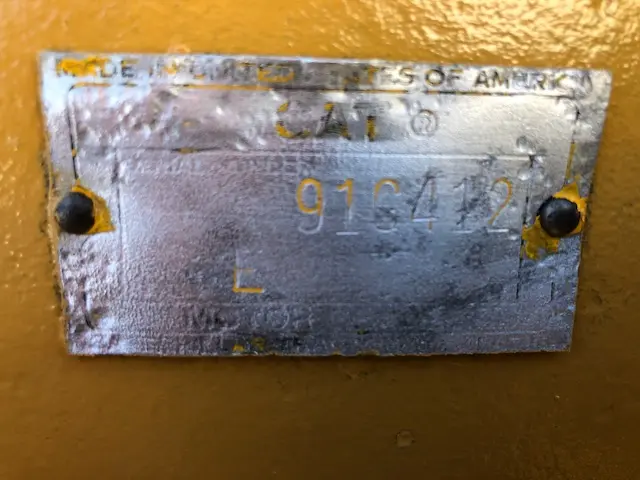

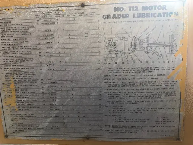

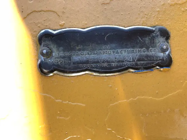

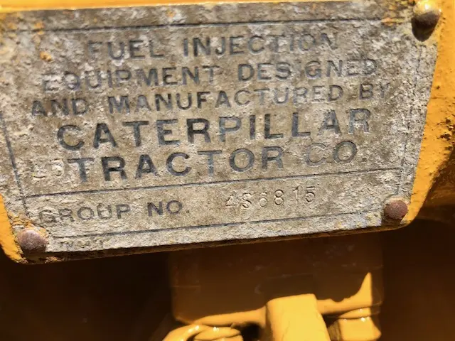

Ok, so the seller got back to me and sent me some more pictures.
[attachment=49054]IMG_5540.jpg[/attachment][attachment=49055]IMG_5542.jpg[/attachment][attachment=49056]IMG_5556.jpg[/attachment][attachment=49057]IMG_5558.jpg[/attachment]
Seller says he's willing to work with the price.
Can anyone tell me what year this is? It's a 112E? I hear these are difficult to find parts for?
I would use it for building/maintaining driveways on my 60+ acres of land. Nothing too heavy.
I should NOT be buying another toy such as this...

112E, 1964, 85hp, 21,200 lbs.
Missing the Scarifier,
If it were me, I would look around for an #12 8T or such, close to the same weight, but more power and should be half the price, for that price I'd be looking for a real nice late model 212.

That grader is a 112E and a 1966 year. 91G 412 by my Cat book. catskinner

There is NO hyd. hoses on that grader. That is CATs power steering on the front of the grader. Front tires are on backwards. Turn the outer single levers, on the control box,so they lean back towards the operator, as those are the lift levers for the ends of the blade and those are the two levers that you use the most. With them back, you don't have to reach so far forward. That's a nice looking grader. Don't go with a 212. catskinner
