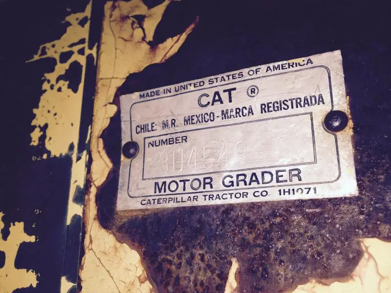

Good morning gentlemen, Justin here from Shaunavon, Saskatchewan. We just bought an old Cat grader, neglected, but at least pull started once a year to grade farm access roads. We have three separate questions:
#1 Frame and motor numbers are 3U4549, what do we have? The big patent number plate on the front is painted over and has some brake fluid working on the paint right now. It was sold by Kramer Tractor in Regina, Saskatchewan.
#2 Got the pony running, starts real quick, sounds nice but it pressurizes the crankcase. Any tips on where to start checking? Tricks to free up a ring if that's the case? Can we run it like this for the short term or fix it right away?
#3 Facing the right side of the grader, looking at the pony motor levers. The longer, more vertical one is the clutch, correct? Shoved hard right (front of grader) is clutch brake, left (rear of grader) to engage clutch. If so that makes the stubby horizontal one the pinion lever. That one is stuck. Hard. Pointed to the rear of the grader. What should we do?
As a side note, this seems to be a well run forum. Thank you all. We have had this grader in our shop for only a few hours but it is already "not for sale". It is actually refreshing to have it in. We run a truck repair shop and something like this is a nice break from big trucks with autoshift transmissions, emissions systems, trouble codes, funky sensors and miles of wires!! And it's pretty cute looking pulled in beside the gigantic tandem steer tri-drive Western Star crane truck in for a new clutch!

Hi and welcome.
You have a late 1953 #112 grader with D315 engine.
Yes you can run it with crankcase pressurized but keep an eye on oil level as these engines do not have a conventional rear seal, just a slinger and reverse corkscrew thread. They will pump oil into the transmission if not vented.

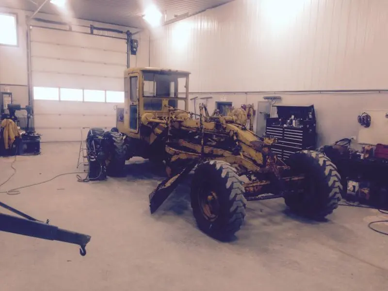

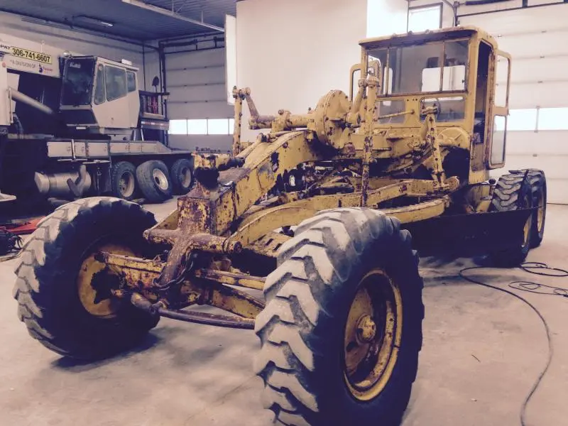

I wasn't going to head to the shop today, but this old grader kept bugging me. Took the inspection cover off, I can see a curved arm with a round pad on it travel about 1/2" when I lift up on the pinion lever and can feel the rod that connects the two. When the pad contacts something inside that housing it stops. I assume it is meant to push a pinion gear rearward on the grader and mesh with the diesel flywheel. If I'm wrong please correct me.
Can I blindly spray WD-40 into this housing hoping it will free up a mechanism or should I put in the time to disassemble? I'm really hesitant to split the grader. Any suggestions would be welcome, as would links to any service manuals, parts diagrams, operators manuals, etc.
And here's some pictures too!![attachment=31482]FullSizeRender (5).jpg[/attachment][attachment=31481]FullSizeRender (4).jpg[/attachment][attachment=31480]FullSizeRender (3).jpg[/attachment][ATTACH=CONFIG]54491
