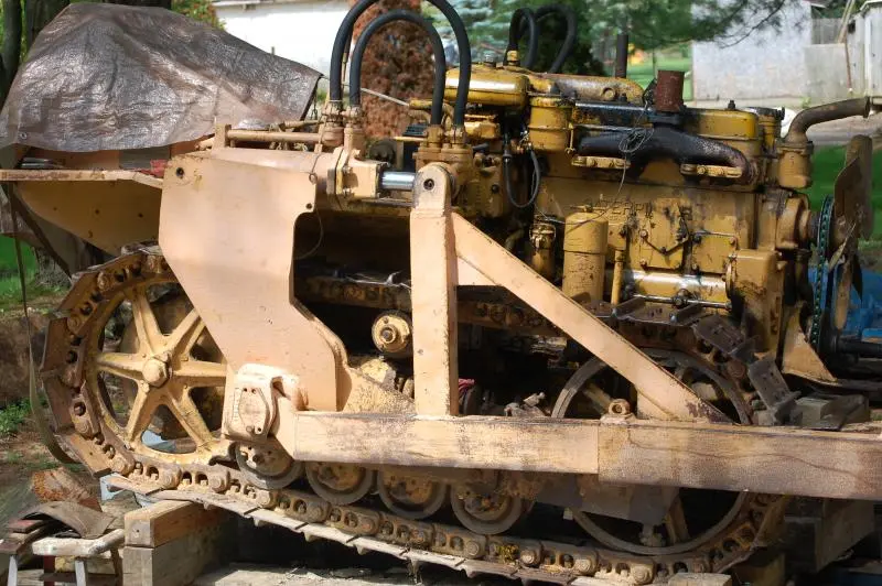

Getting ready to pull the d311 out of my d2. Last two things on the list, pull the water pump and see why it's spraying fluid all over from beneath the pulley and disconnect the fuel line. I pumped about five pumps of regular grease into the water pump, then it started leaking profusely. Does it take a special type of grease?
Anything else I should be concerned with? There's only four bolts left in the bell housing holding it together, the front transverse spring is out, we'll try not to drop it on our toes...

This is where we're at...[attachment=24552]DSC_0003.jpg[/attachment][attachment=24551]DSC_0002.jpg[/attachment]

Looking good - I like your fan belt

That thing is real heavy duty...and adjustable.
