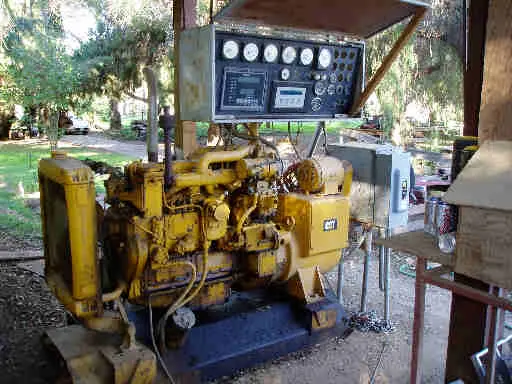

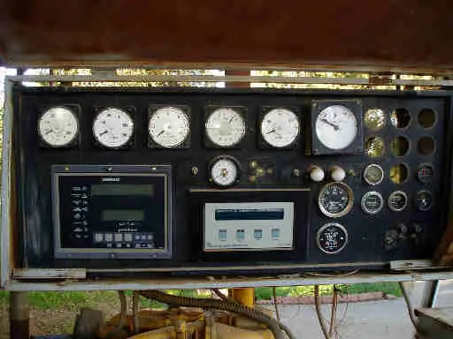

This is my gen set and cont panel. The electric set is CAT 4V7279 which is a d311 with a vendor supplied 30kW generator. D311 is the motor supplied in the d2 4u/5u tractors.
The transformer (gray box with white box on top) is a 3 phase 30kva westinghouse dt-3. This steps down the 440 vac from the generator to 110 vac.
The control panel has an EMCP 2 i bought on ebay. This monitors the gen output. The analog meters duplicate some of the EMCP measurements.
Bob
