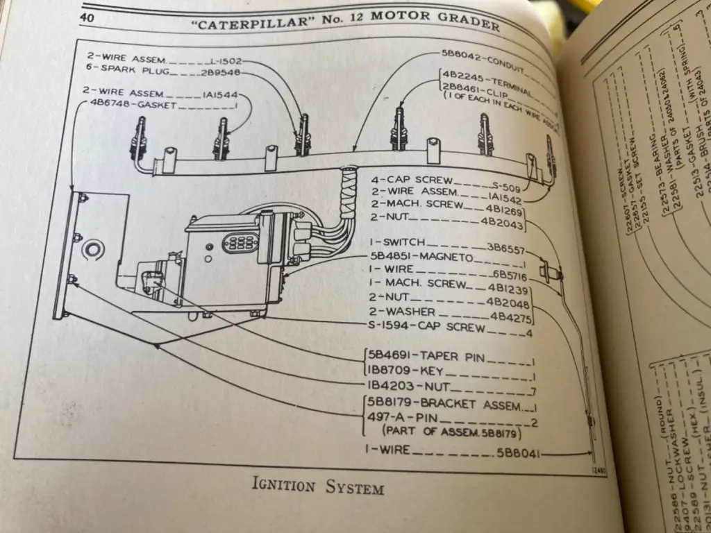

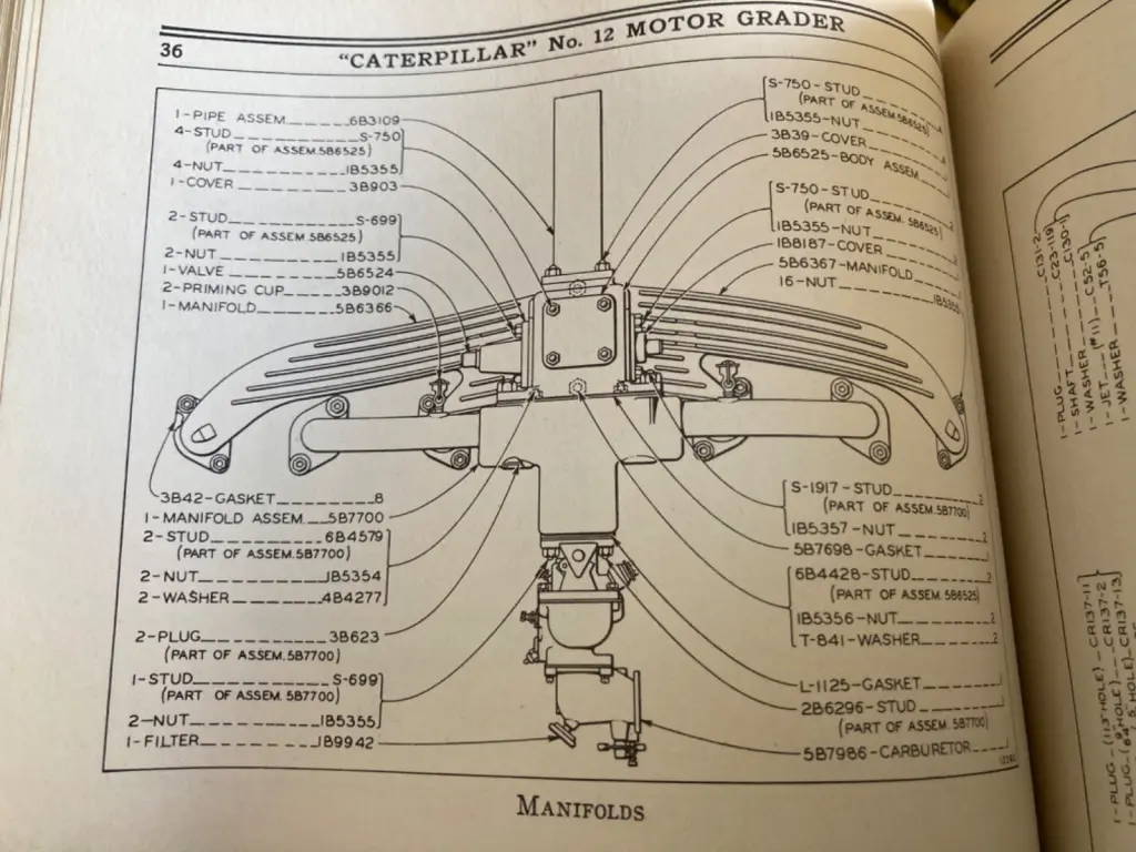

Thanks guys, Bruce, have you tried the option of looking for the requisite parts to make one up? I'd guess the cylinder head and the manifolds might be the trickiest part to find. Pistons could be made. Carb and mag would be relatively easy to procure, even if not OEM. Governor could be a challenge though

Well Neil, as far as I can tell, you should be able to use the front cover pieces from a late R4. Pistons could come from an R4 as well.  The cam shows a different PN from the diesel, I don’t know if the profiles are different, but the diesel cam wouldn’t have the lobe to run the fuel pump. Manifolds could be made, albeit not nearly as pretty as the originals. Heads are the real hang up.  Josh Yoos had the idea of using two R4 heads and cutting them down.  I think that could work if the bolt patterns were the same.  I’d just have to look and see.  BP [attachment=70288]5576B5CD-D6C8-4962-9F79-A22A5968031D.jpeg[/attachment][attachment=70289]BE74295B-826F-40DD-9536-4956BDCF4C21.jpeg[/attachment][attachment=70290]E50E6D6B-DBF4-422C-91EC-2BBBE190D35F.jpeg[/attachment][attachment=70291]906DCAB0-5A22-413D-993F-570EB4E517E6.jpeg[/attachment][attachment=70292]D5549C3F-158B-4316-A8A6-A3E5702BFBEC.jpeg[/attachment]
