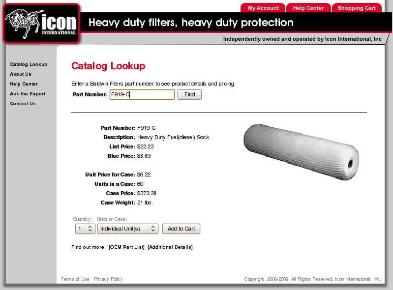

I recently found this place selling a Baldwin filter for our appliaction. I ordered several and their service was excellent.
http://www.adiesel.com/store/itemdetail.php?stocknumber=F919-C
Baldwin filter F919-C at $8.93 each. FYI, this is the same old style filter used in the #44 Hydraulic control. I modified my #44 so I could use this filter instead of the new style CAT filter that costs $80.

This is where I get them. Its cheaper and they get them right out to you. http://www.bfwebexpress.com/
Wed, Sep 2, 2009 7:23 AM
SpragueM
Posts: 242
Reply to OldNuc:
I use Icon (see above post) exclusively. I believe they have a 50 dollar minimum. Also by placing a (4) after the part number you get a set and the price drops even more.
