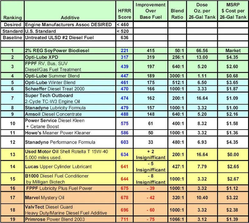

Here's an actual scientific study someone did on that. 2 basic things to learn here: 1) Marvel Mystery oil is garbage and is significantly worse than nothing, 2) 2 cycle engine oil is the only thing other than a proper diesel additive with any positive effect at all.
Unfortunately they didn't test ATF, but people who rebuild injection pumps say it is abrasive and to never use it.
[attachment=55282]HFRRtesting.jpg[/attachment]
Back in the early 1990s, I flew a Cessna 195 with a 300 hp Jacobs radial engine. These old, low-compression engines called for 87 octane aviation fuel which was no longer available and only 100 octane low lead was available. I was advised by the previous owner to put TCP fuel additive in every tank of gas to reduce lead build up and to run a pint of Marvel Mystery Oil per every 60 gallons on every third fill-up to lubricate the top end. I put 300+ hours on that airplane and the compression never decreased. I have no clue whether that was because of or in spite of the oil.
I've been told Marvel Oil is just ATF in a fancier can. Looking at the chart above and the results each oil gets, I now believe it.

I can only state from my personal experience, NOT from what 'someone's' test showed. :lalala: I've used Marvel Mystery Oil (MMO) for years in just about anything with an engine and always gotten many more miles and hours of use than the average. My dad was a mechanic (not a 'tech') all his life and swore by it.
I also use their 'air tool oil' in all our air tools with great results.
MMO was designed for 'top end lubrication' when mixed in fuel...which is exactly what 2 stroke oil does for a 2 stroke engine.
What exactly was this test testing? Better performance? Better fuel economy? Longer engine life? :noidea:

Crawler Dollars, I hear you. I've always been skeptical, though. In comparing my experience with other pilots running old radial engines at the time, most were not adding the TCP or the MMO and their engines did not show any excessive wear or other problems. On the other hand, the FAA requires overhauls of aircraft engines at either 1,800 hours or 2000 hours in most instances. So typically aircraft engines are torn down and rebuilt before they have the chance to fail... at least in most instances.😞
