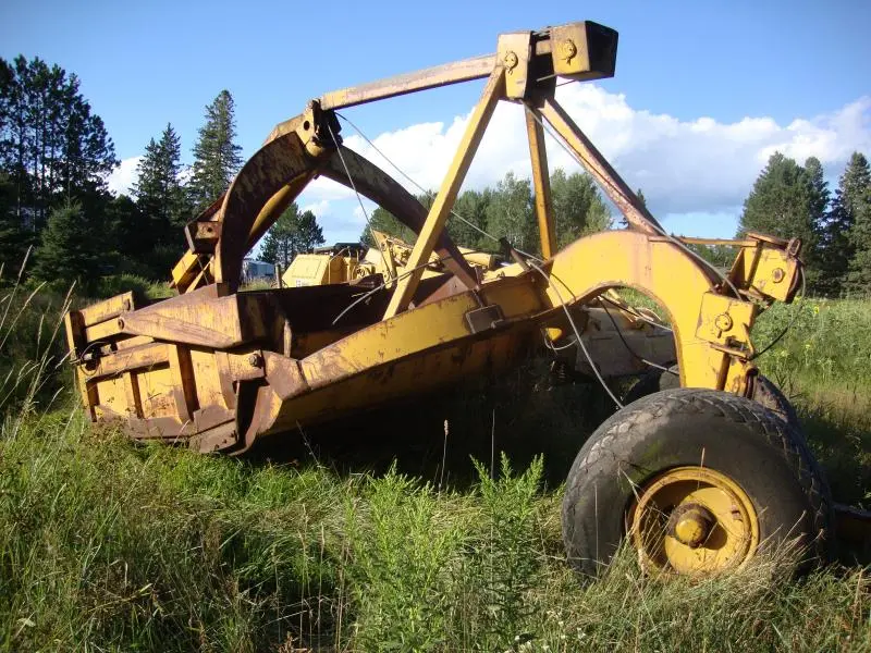

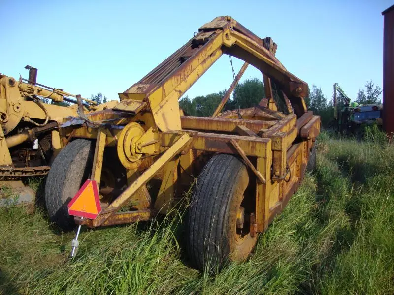

When I was 16 in the later 1960's my cousin and I buried "garbage" barrels at a remote wooded site in MN which came from a plant in Minnapolis. We used a D7 and a D8 with pull scrapers. Incidently the site is now a super fund site and all fenced off. A week ago I located the scraper that I pulled with the D7 and bought it, recovering it from the forest it was parked in. The owner said he had not moved it in over 30 years. The tires still had air in them. I am attaching a couple of pictures. I know it is a LeTourneau built in the days before Cat made there own but do not remember the model. The serial plate is long gone from the back right corner. I'm sure somebody will be able to ID it from the photos. It is about 8 yds capacity give or take if I remember right. Hopefully before to long it will be connected to my 2U-D8.

Quite a find....and in remarkably good condition to..
The Model LS Letourneau was about 8.2 cu. yds struck and 11.0 heaped.

Darned good looking LeTourneau Scraper, and the tires are still inflated!!! Pulling this with your 2U should be a piece of cake for the 2U. Plenty of power there. Thanks for keeping the "Old Iron" moving and being a "Living historical museum" for the rest of us - - nice "eye candy"

Thanks guys. Your knowledge continues to impress me. I know you can't look it up that fast so your brain's must be in good shape. He has an old D7 that was setting with it. Not the same one I ran. Engine block is laying half buried in the ground, the head is rusted solid setting on the tracks, radiator is laying half growed into a tree, but the tracks are almost brand new. Ruined the crank he said. I tried to get a package deal but he wants to keep the 7 for a while yet. I think he is waiting for scrape prices to go back up.

Just curious, did you ever have it upside down? -Jan

No, I never did turn it over. It seems to me it would be hard to do with the back axles in the cut. We never cut any slopes though. Or do you mean is the bottom wore out. The bottom of the tub and the cutting edges all look like near new.

Hi, Old-iron-habit.
NICE find and thanks for sharing. Your 2U should waltz away with that.
I think the earlier reference to turning it over was more about roll-overs than about maintenance. Those old LeTourneau scrapers acquired a nickname of "LeTurnover" due to the fact that the unwary sometimes found themselves dragging what might best be described as a 'boat anchor' 'cos they had not been paying attention and the scrapers wheels were no longer in contatc with Mother Earth the way they were designed to be. All that lift mechanism and spring assembly up so high tended to make them a little 'wobbly-booted'. Side-cutting batters was not one of their better 'things'.
