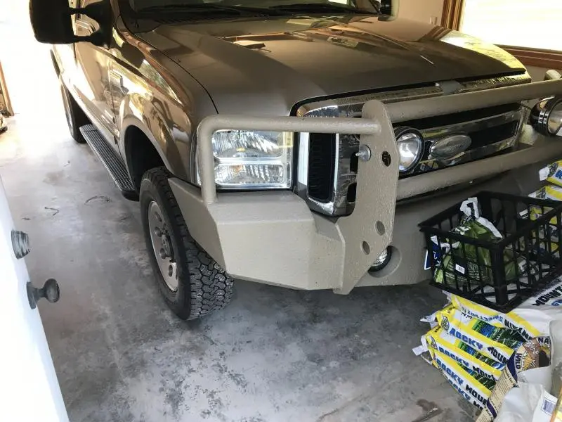

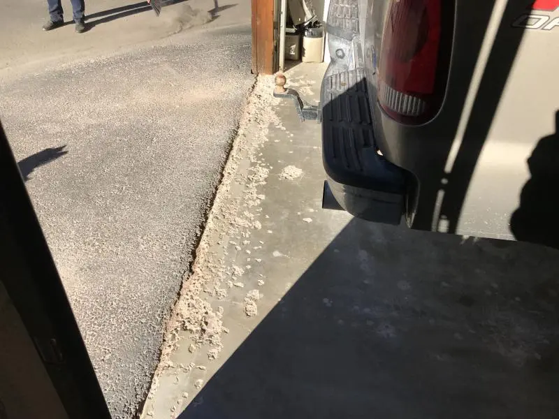

About 8 years ago we bought a quality tarp water collection set up. Worked ok but kept the water and melting ice contained so your always tromping in the water.
The garage floor is very smooth except around the door area.
Seems like it needs a thin layer of concrete with a slight slope were the water and chucks of ice will run to the center then out.
Please advise on how to solve her problem?

CC. No im not sure about the slope of the garage. There is plenty of clearance to pull her pick up in.
I can see what your saying about delaminating as it freezes. If there were any cracks or water got under my new thin slab the ice would break it up.
TOG, big bumpers are good. Lots of deer up here. Makes me nervous riding my bike when deer are standing on the road side looking at you.
DP, that sounds like a good idea trying to cut grooves. Would it break up the floor if it freezes? Or would the ice just push up and out if the grooves aren't to deep?

Sawing a grove slabs that have a puddle is quite common in the commercial world. In my sisters garage I cut a single approx. 3/16" groove from the low spot puddle out thru the door. It had no spalding over the 5 years she owned it after cutting the groove and it never had a puddle during that time. If unheated the water should not run in when cold and freeze. If warm enough to collect , it is warm enough for the water to run out. A day rent Partner saw with a concrete blade is a easy way to cut them. Quick and easy. Even if it doesn't work for you, no harm, no fowl, pour the overlay over it. If you pour a overlay go 2'' thick with a pea rock mix. Throw some #3 bar in it at 12" centers. The extra thickness will also help you stay dry as well as not flake easily.
