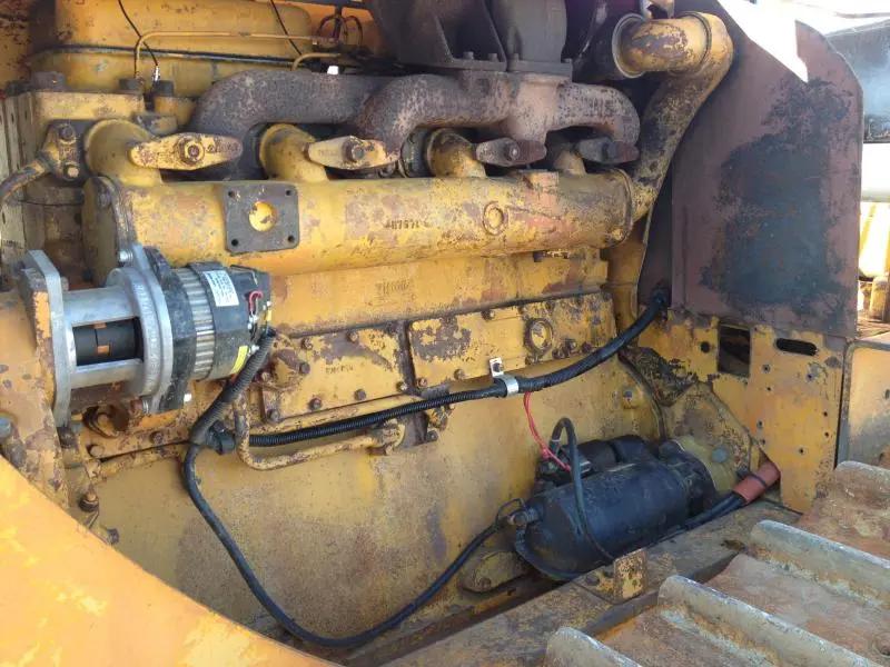

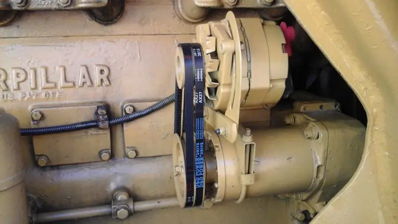

Hello LJ. I can take a photo of an alternator with adapter that takes the place of the generator. Pretty clean adaptation in my opinion. Coupled with a Lovejoy style coupler. I found one of an old 17A of mine. More photos tomorrow. JM

I believe this is the current preferred unit...
Try Florin Tractor, I think they have them. Not cheap though.

This is what I did on D69U. One wire alternator, works great even at low idle.

Thank You everyone for all the Helpful advice and Pictures , I will start Checking out all Ideas , Dozerdougs photo is similar to what I have seen on a D7D17A, and its been working for 30 odd Years. Thank You all. LJ

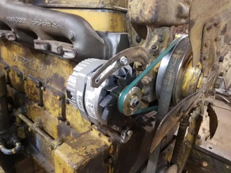

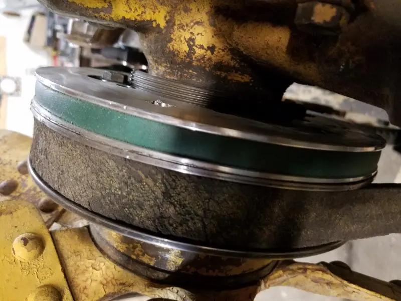

I did this for a 9UD6 with a cable blade. It left the gear drive generator open to make an adaptor to drive a hydraulic gear pump for hydraulic controls to angle and tilt the blade. Speeds up the rpm of the one wire alternator to charge at a low idle. Does not affect the tightening of the belt which runs the water pump and fan for cooling. [attachment=56132]20190821_201209.jpg[/attachment] [attachment=56133]20190821_201059.jpg[/attachment]
