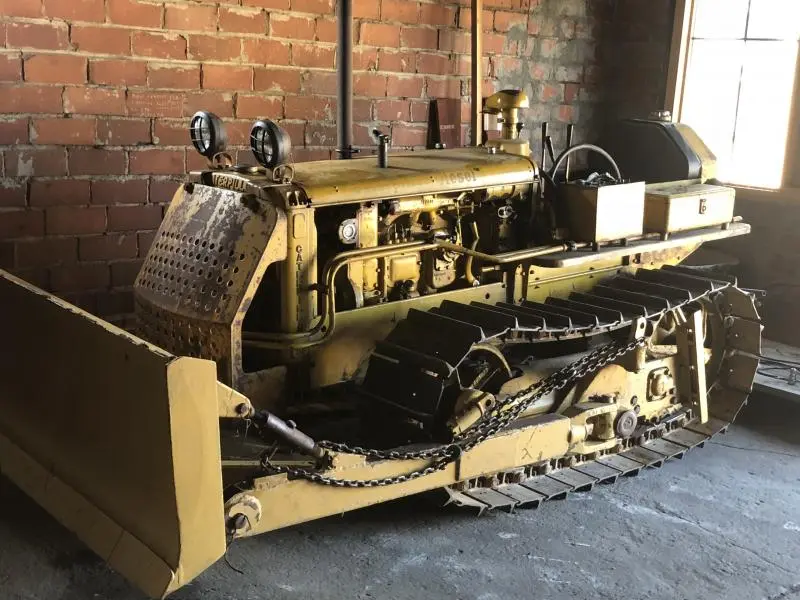

After a couple years finally mounted the blade on my d2. Have not completed hydraulics. I have an original right cylinder but am still looking for a rebuildable left original. Need to replace some new pins but getting there. I know I should have a different idler on the front but I am not going to worry about it.

Looks good. I think you have the piece that mounts backwards. On my tool bar dozer the pin is on the back side of the trunnion. Just my opinion.

Great call. Yep I have it wrong. Wondered why my cylinder seemed too short. Nice catch. Will also make it less nose heavy.
