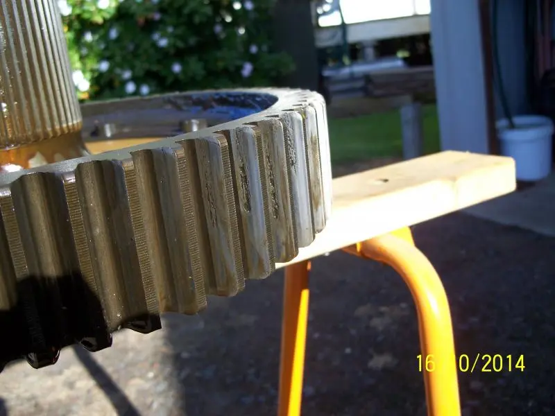

Hi all just pull the final drive gear housing of to do the bearings and bellow seals for by RD4 and just wanted to show you this and get your opinion, it is probably the same as mine.

Hi Daryl, where is the rest of the teeth? Do you need a dentist?

I would replace it or if its a parade tractor just switch it to the other side of the tractor if you have the the other side apart. Might have to replace the pinion gear too.

Hello Daryl,
The good news is that if those bad teeth are on the pressure side for reverse, then you can get away with keeping it, if it's for a show pony.
If it's not, and you can't get a new one (at a good price) then I would spend some time cleaning the teeth and then carefully fill the pitted areas with phosphor bronze and then dress back to the correct profile in a shaper or similar. Oh, and I would quench the teeth as soon as the bronzing is done on each tooth. That should maintain some hardness. They are usually only induction hardened on large gears. Plus the bronze will add some great bearing properties.
At least it's repairable. 😖mile:
Phill.

You need to put out some rat poison, that's a rat eaten gear. What would I do? reverse the gear and drive on, it will last for years. Some tractors you can reverse the gear on the same side, others you have to swap sides.

Hi all i have decide to put it back in and just drive in reverse that will fix all the problems, and the gear box had the same rat problem so i'll put them in reverse that way when i go in reverse i'll go forward. :bowl:
ROME/KG Yep the pinion and most of gears in the box was buggered too, so i replaced them all with the ones from the spare machine and i be will this weekend start pulling the bull gears from the donor too as i now they are like new
Andrew i put some rat sack around to keep'em out
Wombat Pon's good she will be coming to the meeting on Friday
Hi Phill thanks for your reply i would never thought of that a very good solution i will keep the gears in case some one requires any
PS: this is the good side i post some more pics when i do the other side.
