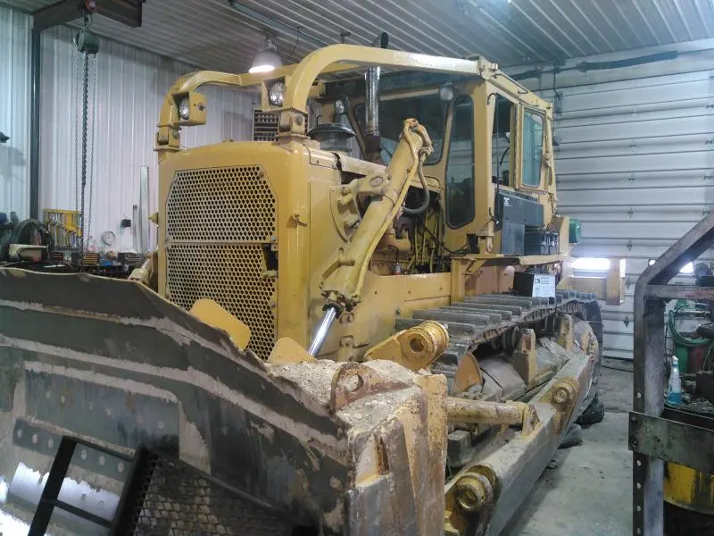

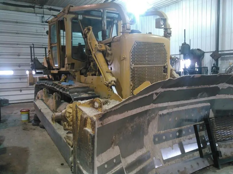

What no pictures! A D8 is definitely a serious machine. I would make 2 laps around my property and wouldn't have any more work for it

[attachment=57176]KIMG0011.jpg[/attachment][attachment=57177]KIMG0010.jpg[/attachment]

Sweet Thats a nice looking tractor.

That OUGHTA doowitt - should just about get yer turnips dug up - - - - if'n yer don't put too much fertiliser on 'em.
That blade has had some fairly serious resurfacing but overall it looks good. Thanks for sharing.
