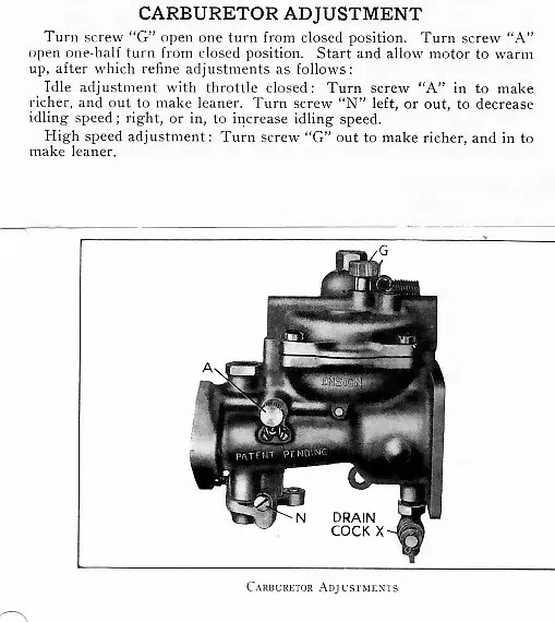

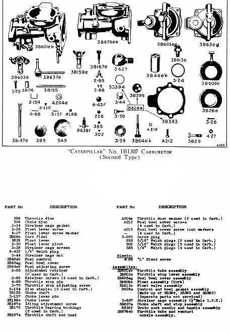

Hi Team,
here are scans from my Parts Book and my General Instruction Book For Early Products out of the 10 Tractor Instruction Book section.
Hope this helps.
Mon, Jul 5, 2010 6:33 AM

Reply to Dunefanatic:
Nice wide ten Mike
edb,
Thanks Ed for the scans,I'll print them off and I'm sure they will be a help! That's more than I have on info for the carb anyway.
