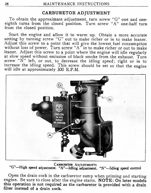

Looking for parts and a picture of the parts breakdown for an ensign carb on a thirty cat.

which model of carb do you have?

You might check these folks out https://robertscarbrepair.com/

I finally got back on the computer. The carb in the left picture is my carb. Thanks for the replies I have used that carburetor business in the past but only for John Deere carbs I will contact them and see if they have parts Thanks
