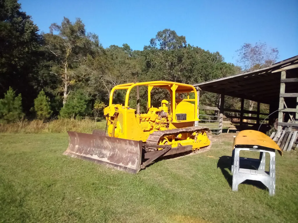

My early 1950's D6 9U cable dozer ran beautifully until I tried to start it two days ago. The pony motor cranked the diesel engine as usual and the engine started to run, but needed more warming up to keep running. So I engaged the pony motor again. I heard a clunk and the the pony motor immediately stalled. Now the diesel engine will not spin. Any idea of the cause and how to fix?

Update: After removing the inspection cover from the flywheel clutch clutch housing, I was able to see that the pinion actuating lever is intact, but not contacting the pinion assembly. I suspected that the pinion sleeve came loose somehow and had gotten jammed up somewhere. I partially disassembled things to gain access: Removed the hood, dash, air cleaner, floor plates, pony motor flywheel, and have gotten ready to remove the top part of the flywheel clutch housing. Sure enough, the pinion sleeve with the latches had gotten in the clutch mechanism and jammed up (which explains why the engine was not turning). I was able to retrieve it after getting the clutch housing loose. There are supposed to be small screws secured by wires to hold this sleeve in place, but these are missing. Now that I know what the problem is, I think I am looking at removing the starting motor clutch assembly and repairing or replacing it. This requires partially removing the pony motor to obtain clearance for removing the starting motor clutch. I have two parts dozers of the same model, so replacing may be the easiest option.
