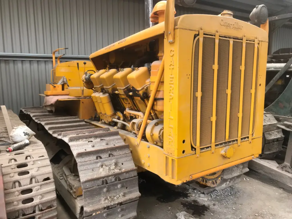

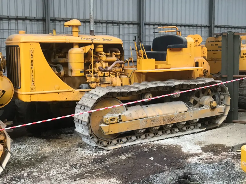

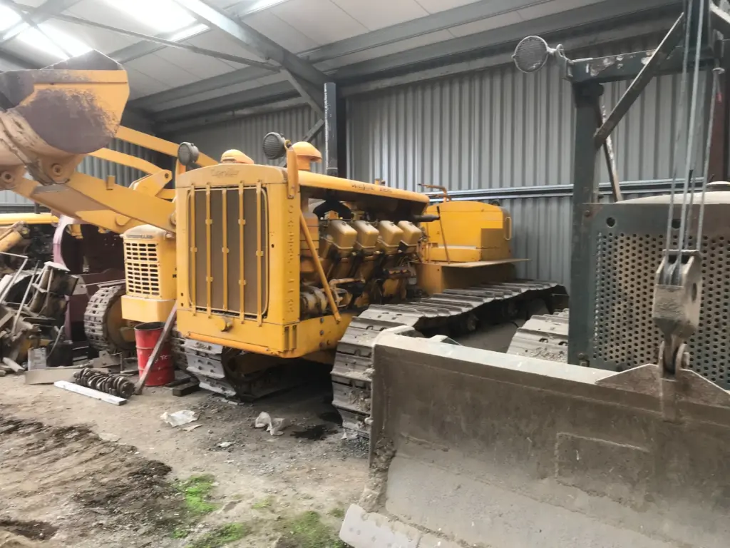

Here are some pictures of two impressive re-engined D7 tractors, both genuine period CAT engines.
First up a conversion to a period 6cyl D8 engine (D13000 ?
 [attachment=64500]IMG_1991.JPG[/attachment]
Second up a D7 conversion to a V8 period Cat engine (D17000?)
 [attachment=64501]IMG_1976.JPG[/attachment]
 [attachment=64502]IMG_1977.JPG[/attachment]

Reply to gauntjoh:
