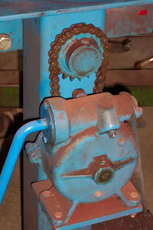

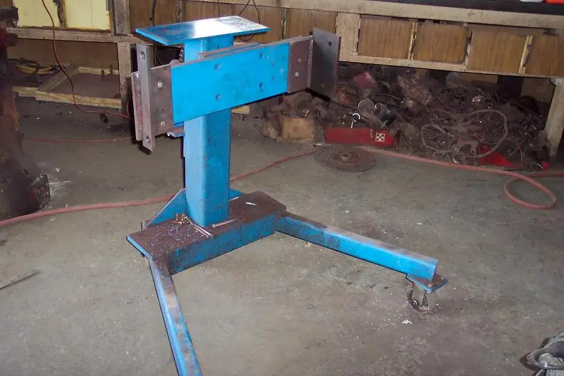

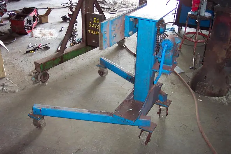

Here's one my brother built...has a salvaged worm gear to turn heavy eninges/transmissions. You can see in the pics that he makes special adapter plates for specific use. It usually mounts on the side of engine/trans rather than the end, but could be used either way.

that is just sweet!!!

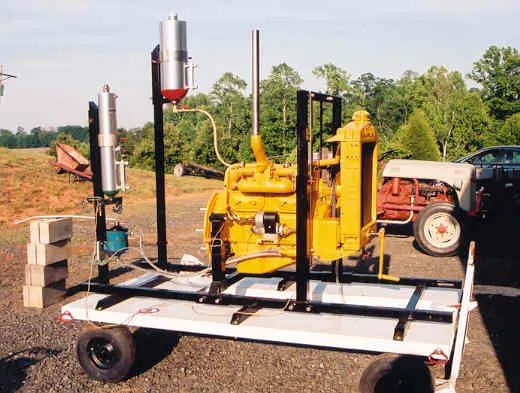

I helped a friend of mine build this test stand...it will adapt to almost any engine. OK...not a radial engine or large diesel or...etc
That is my TEN engine just before we started it for the first time. This was several years ago now.
