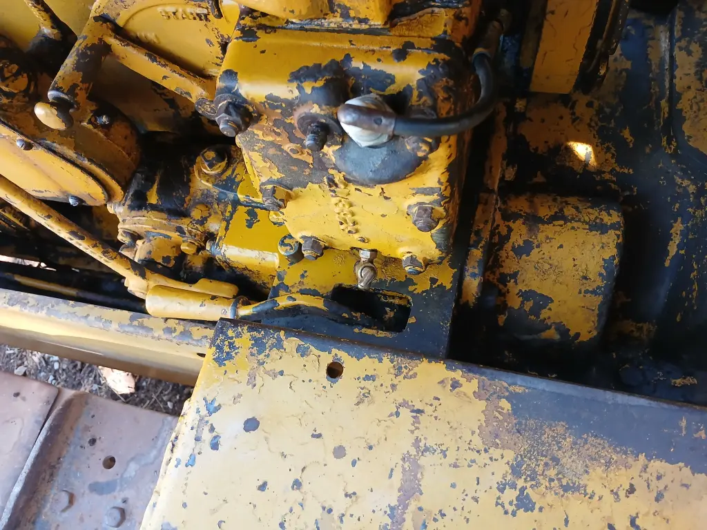

Curious if someone has a tip for gaining access to adjust the starter pinion latches on an early RD4 without having to remove the entire thing and hope you get the adjustment right. Since it doesn't have the little round access cover I'm wondering if taking the clutch adjustment cover off the bottom of the bellhousing and maybe get at them with a long screwdriver? Can't seem to find much info with the manuals I have on hand.

Interesting thread. I am curious as well. Same goes for some older D2's? It can be difficult enough to adjust latches where the dinky access cover is located, smack dab in line with the dash panels! I wonder if anyone has a secret method of adjusting. JM

I remember we rode the struggle bus with this. Can't remember the video though. It can be done.

Pretty sure we went through the plug hole in the top. It is tedious but it works.

CrawlerAddict, it's easy enough to drill a hole in the cover so you can adjust the latches. I drilled the electric starter hole in my 5U and it only took maybe 5 mins or less with a regular holesaw from the hardware store. Drill and tap a couple of holes and fashion a cover out of sheet and you're good to go. The only complication I can see is if it's hard to get the right angle with the drill but I'm sure you can figure something out. As annoying small as the OEM hole is, it's better than having no hole and you'd have the benefit of being able to maybe make it a bit bigger than standard

There is no OEM hole folks...I asked a seasoned mechanic and he was stumped as well. Hang on to the pinion lever!

What I meant is that the OEM hole on later machines is small, so since this RD-4 doesn't have a hole, he can put whatever size he wants in. The more generous he can drill it, the easier it will be to adjust. The D2 hole size is real difficult for my XXXL hands

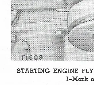

Maybe some kind person could measure the center position of the pinion latch adjuster hole in the clutch cover for CrawlerAddict.
Scan is from a D4 U series and could be a place to start using the hump and bolts for reference for your G series????
I have seen pipe plugs screwed into the covers which may have been a Cat modification for early units without the cover plate type access hole.
A search of my incomplete Service Magazines from the day--1937-8-9 does not find anything but there would surely be something in the Cat system on this in early literature.
