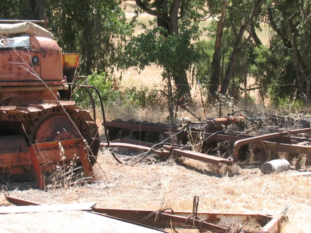

I know the dealer selling a brand could cover some short coming of the equipment it self, up to a point. From what I saw being used Dyer discs where number one in this area. There were Towner, Goble, Killefer, and Allis Chalmers discs in use in my youth. As a kid always wanted to pull the Dyer rather than the Towner that were the most used tillage tools we had. As the Dyer had a T shaped hitch, were the Towner was a A. Almost impossible to turn to short with the Dyer, always having to watch the Towner to keep the track out of the hitch on a short turn.
The Dyer hitch was built so the drawbar could slid right or left on the channel iron part of the hitch putting your tractor closer or father from the trees being cultivated.

Finally. Pictures to show what I was talking about with the hitch. Picture number 1

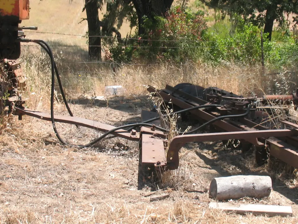

Picture number 2

This is a early disc in that it has cast iron box bearing. The tube axle discs are more common around here.
The pictures show the channel iron and the holes to adjust the draw bar to ether side. Only had the one bolt take out to move it. I have never tried any other position than the middle one.
And the quick and dirty farmer engineering to add hydraulic to the opening and closing. A great help with how sticky the most of the dirt is here. The original bar is still in place just removed the pin and spring.
