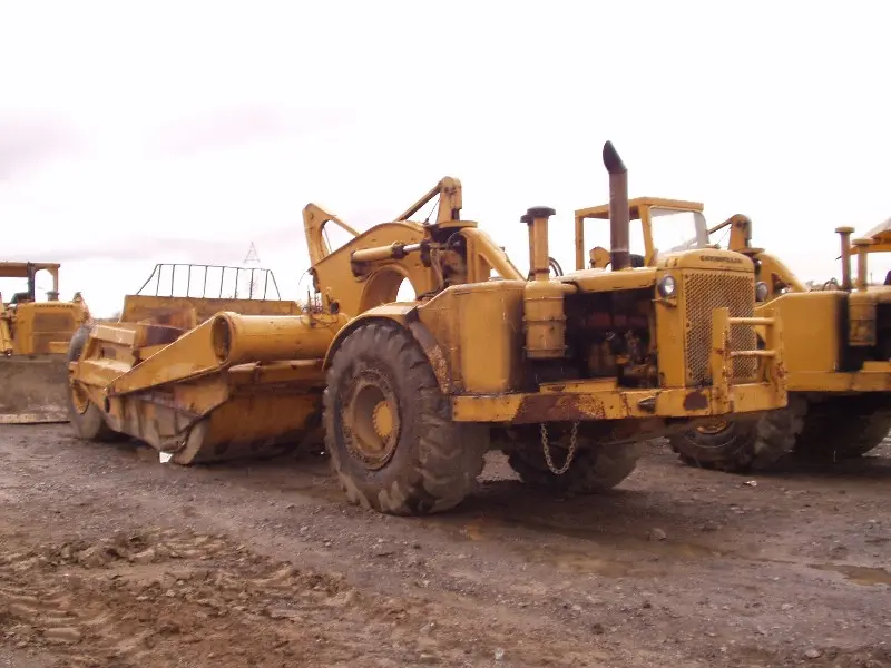

I operated DW21's for about 24 years and still admire the design. I saw 3 working in Kingston, Ontario this fall; will try to attach a picture I took. The 86E was the best since more horsepower was always helpful to have. They had an excellent steering system and steered like a Cadilac. The 621 doomed them when speed became something everyone wanted to see. I heard of someone putting a 3406 in one. I still have some D337F parts including a cylinder head and crank. Phil
