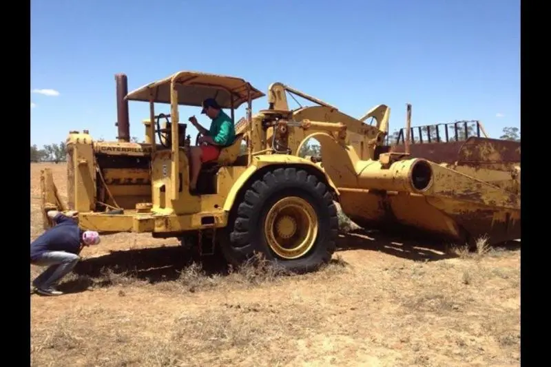

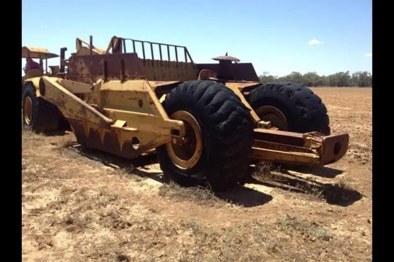

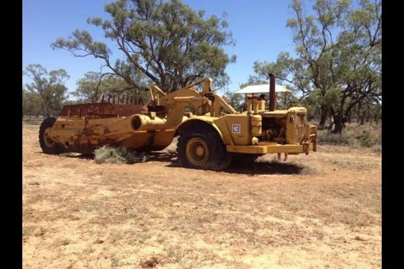

here are a few pics dan sent me on the weekend of the machine in question, lets hope the owner will part with it for the right price or dan digs up another jam tin, would be great to see it going rather than cashed in for scrap
[attachment=21434]IMG_1121.jpg[/attachment][attachment=21435]IMG_1119.jpg[/attachment][attachment=21436]IMG_1118.jpg[/attachment]

Looks like at least three of the 4 tires will hold air. Hopefully the 4th will air up to. Can not tell if it is off the bead by the picture. These old DW 21s and the DW 20s hold a special spot in my heart. I have my mind set to get one in my stable some day. I hope you guys can score this one.
Best of luck in making a deal,
Roger
On a side note one of the things that I always notice on the 21s is the square cut 90 degree bend on the smoke stack. I often wonder how much more HP could be realized by having a mandrel bent 90 degree exhaust pipe to smooth out the exhaust gases flow. Anybody got any theories?
