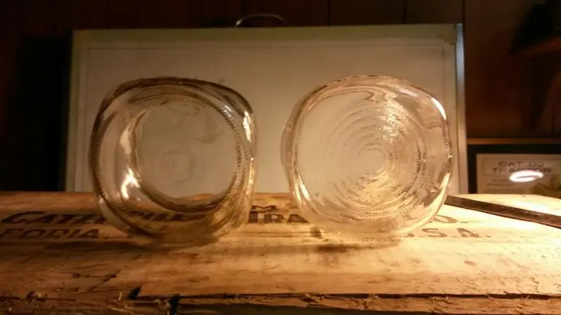

correct 4 the replacement plastic jar only, the v fitting is metal and not removable from the plastic jar plus it fits the v clamp groove . the glass jar uses a rubber oring, its placed on the jar so the v clamp clinches and seals it. o ring maybe available at ur hardware store.
here u go, the oring is placed below the glass flange, the tightened v clamp holds the jar by compressing the o ring to the glass flange.
this o ring is about shot!!
[attachment=30289]SAM_2881.jpg[/attachment]
bruce, looking at the photos again i wonder if the new jars flange is proud "purchase" enough to keep the o ring from riding up over it when tightening the clamp ?![]()
