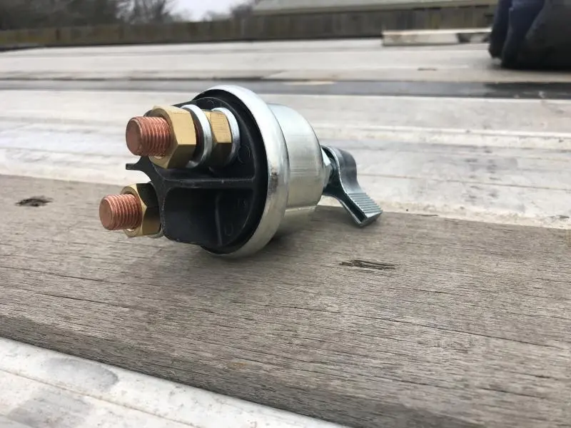

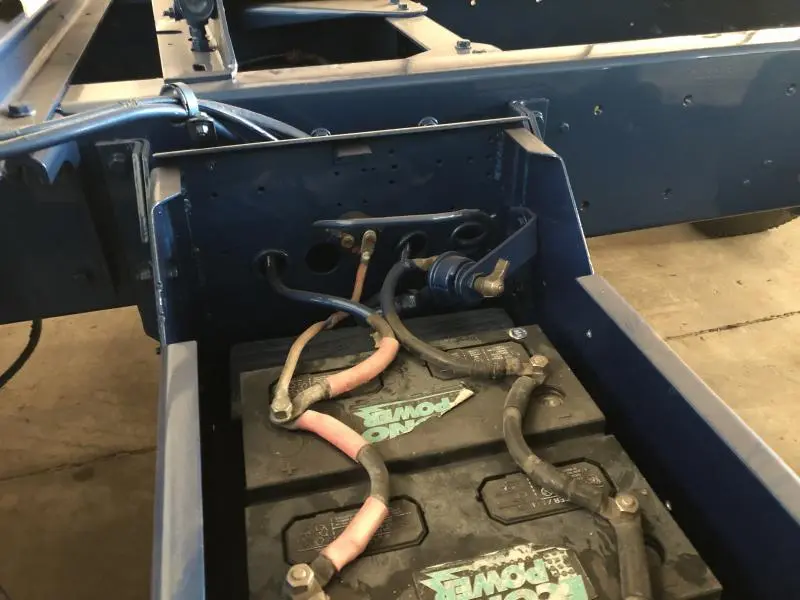

I’ve seen trucks burn to the ground from electric fires and I’m often working on it. It’s a pain to disconnect the batteries. I would like to put a disconnect switch on my 2015 KW. It has 4 batteries with two ground cables running to the starter. The cable ends are 5/8 and the disconnect switch is 3/8. Any problems you see with putting two 5/8 cables on one 3/8 stud? Then running two cables down to the starter with the proper size ends. Or any problems putting a disconnect switch in?
Thanks for the help again.

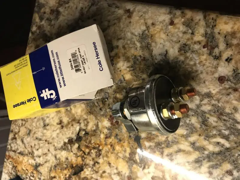

Step up to a Cole Hersee #75908 switch. Higher amperage rating, silver contacts and 1/2" studs. Having a battery disconnect switch is one of the best moves you can make.

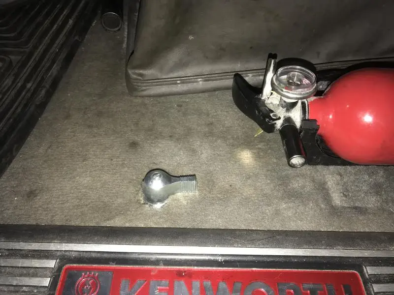

Thanks guys. Got the 200amp switch. Much better with 1/2 studs. Only cost $65. Why does Cat always put the switch on the ground cable and not positive?

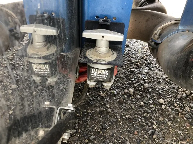

Here ya go Mike. Paccar factory disconnect switches. My older 2002 had a pair of them mounted through the floor left of the driver seat. Pull up and twist to disconnect...
Flaming River brand from factory outside of battery box. Have them in all of the trucks but never use them!

Another Mercer driver had his Paccar truck catch fire going down the road so I put mine by the seat. Only cost $105. Switch 65 cables 40. Already had the 49/64 drill bit.

That switch is rated 2000 amp intermittent (30 seconds) and 300 amp continuous.
