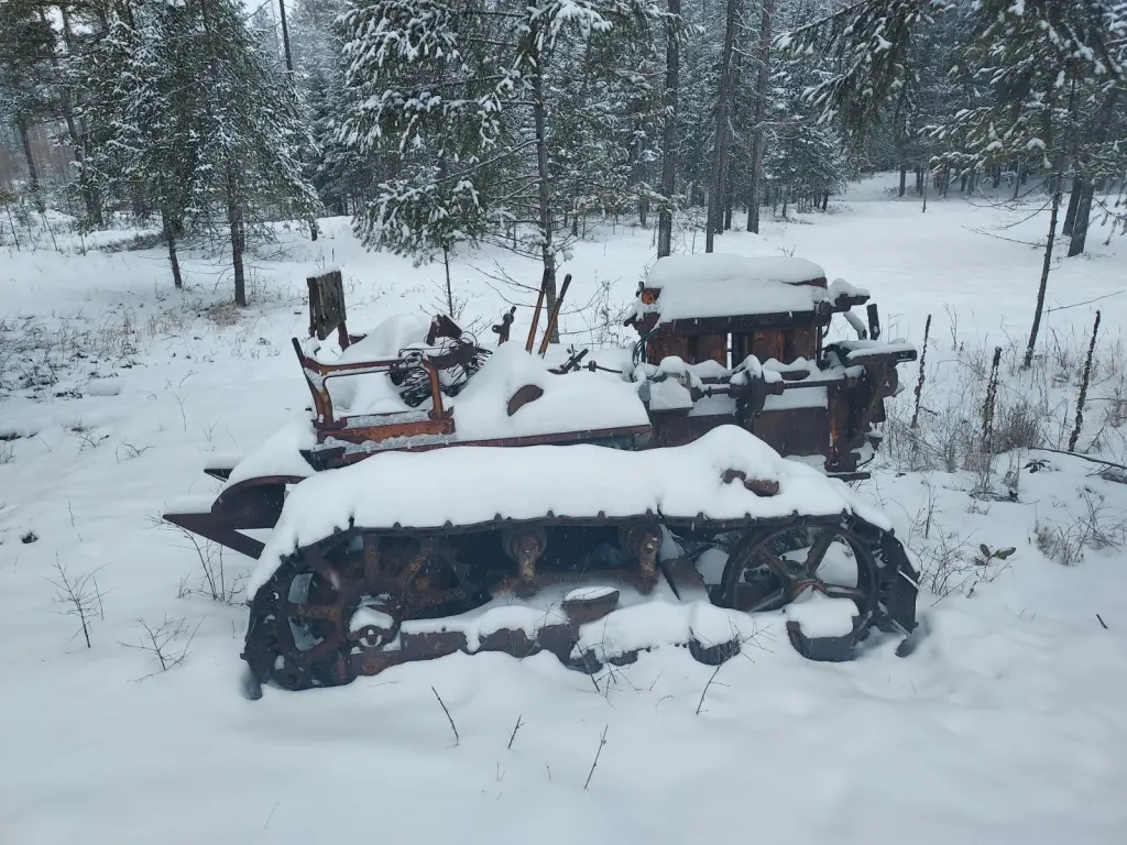

I have a wide 30 that I rescued from the scrap yard, I can get pictures if you're interested

I can get some pictures in the morning. I'm in north Idaho

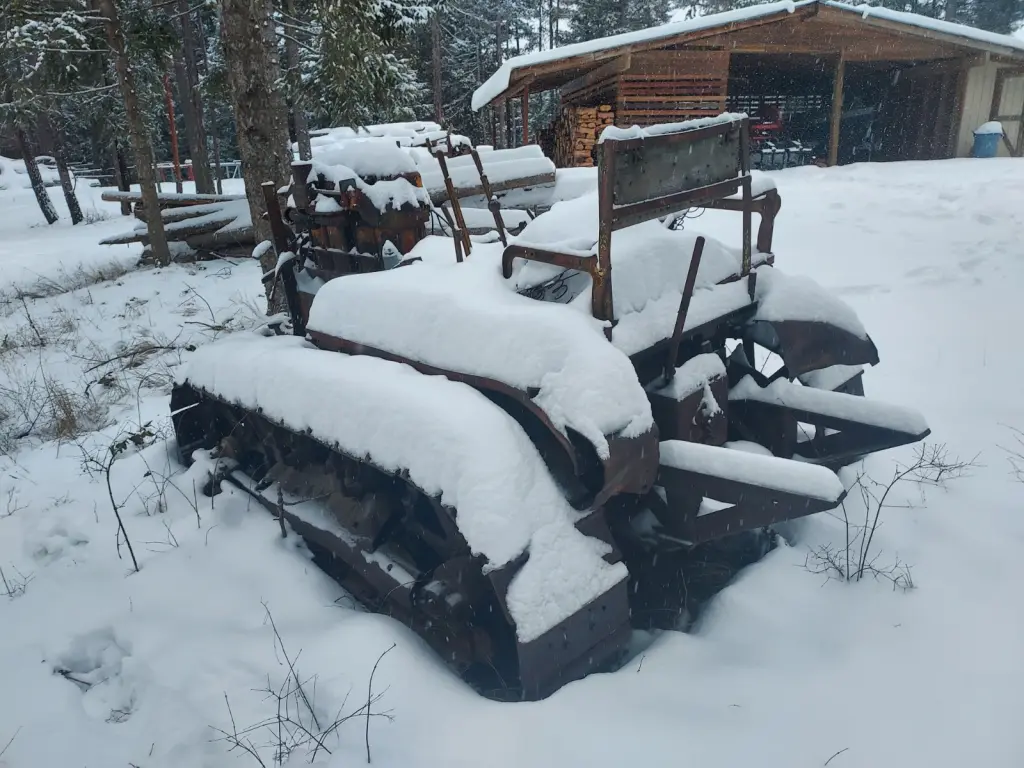

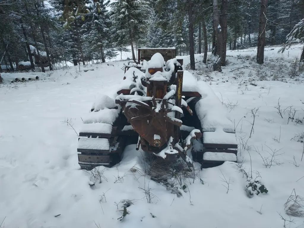

This will give you a general idea, big storm came in last night
  [attachment=75001]20240117_093433.jpg[/attachment][attachment=75002]20240117_093424.jpg[/attachment][attachment=75003]20240117_093414.jpg[/attachment]
