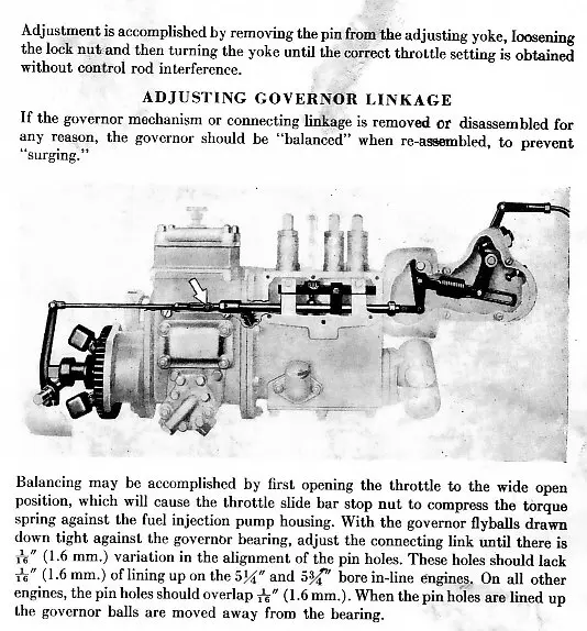

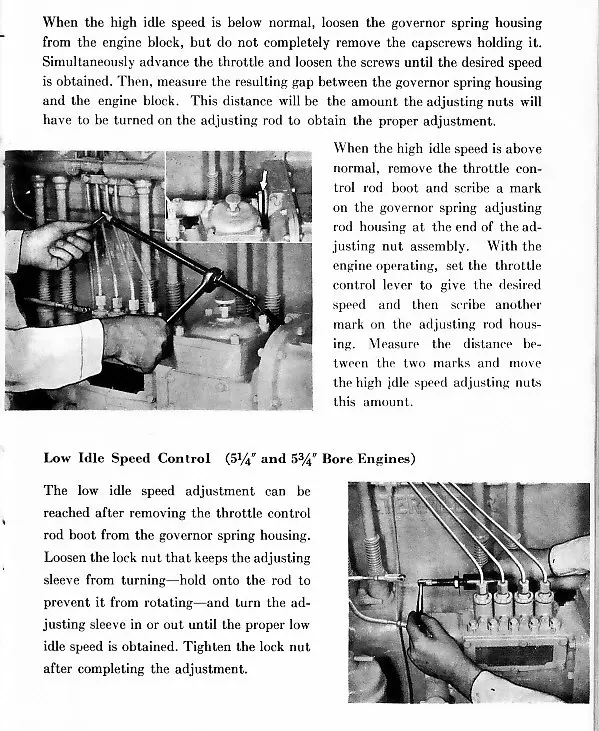

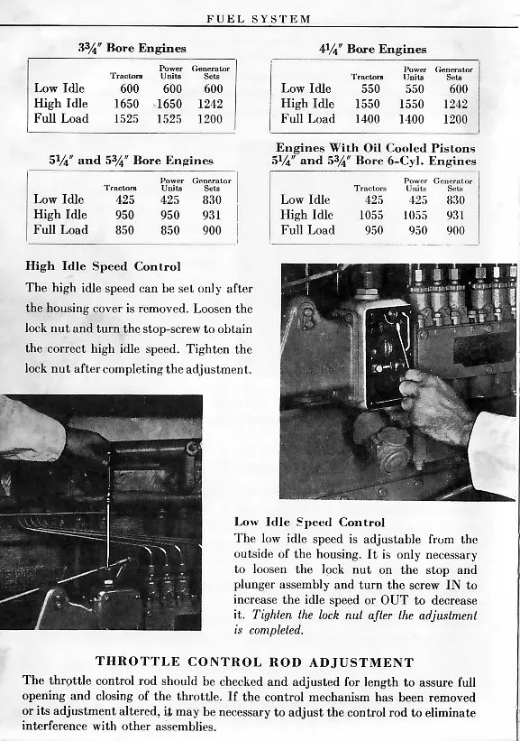

I was wondering if any of you could tell me how to set the governor speeds on my diesel forty. I would like to run the rated speed up to about 950 RPM for use on our sawmill. I don't think that should be a problem since Caterpillar ran a Nebraska test at both 850 and 1000 RPM. I also have a diesel fifty I would like to slow the idle speed down a little. Thanks for any help. Dave

Hi Team,
scanned below is all the Early Diesel Engine Gov. Setting Data I have.
It is taken from the Serviceman's Reference Book on Caterpillar Diesel Engines, Form No 5060B, dated 12-47.
Shown is the first generation stuff, and the second generation stuff for future reference as needed by others in future--Grab 'em now while they are up.
Hope this helps.

Thanks for the information , Eddie. That's just what I needed. -Another question- I have a pulley on my Diesel Forty that was originally on a PS series Thirty. The pulley has a brass plate on it that says to periodically put the transmission in high gear and operate for a few minutes to lube the transmission bearings. Do you know if that is necessary on the Diesel Forty since the transmission design is quite a bit different. Thanks again. Dave
