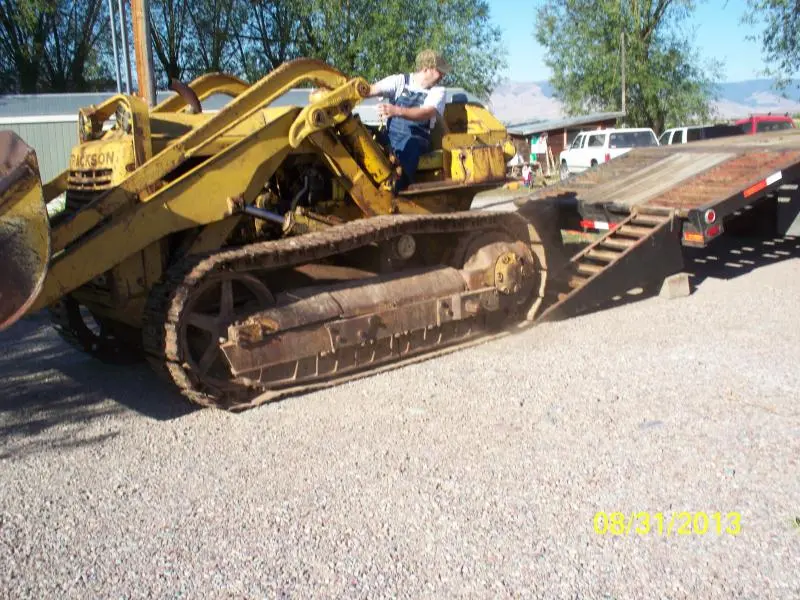

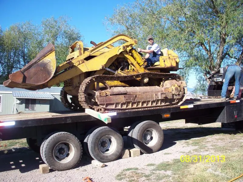

Its 5:30 am and ready to leave Kellogg Idaho to go to where my D47U is In DeBorgia Montana.We will meet the guy thats gonna haul It to Charlo Montana. Ill take pictures and post the to this thread later. Pretty excited about it all kinda of like Xmas morning for a little kid. Even the wife cant wait to drive the ole Cat[attachment=19238]100_2418.jpg[/attachment][attachment=19239]100_2419.jpg[/attachment][attachment=19240]100_2423.jpg[/attachment][attachment=19241]100_2420.jpg[/attachment]. Was a long day here are some pictures for you all to look at. Also picture of the Id tag Does anyone know what year it is? Thanks Dan

If I read the serial plate correctly it is a 1952 according to the ACMOC Track-Type Machines Serial Number Reference Manual.
