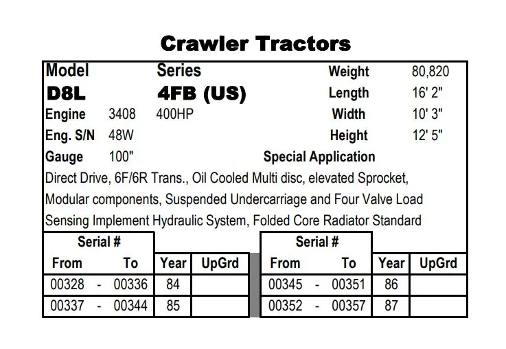

 12 ? or so came to Queensland Australia , all came up fpr Aution on the same day ,i think they where used on cotton farms ?
[attachment=71903]d8l sa.JPG[/attachment]

Interesting where some might have ended up. The initial spotting, I said that HAS to be the oddest looking tractor (being a hightrack) pulling a drag disk of things. It is supposed to reside along with other crawlers this guy owns, and nothing for sale sadly. Nothing. They hold tight to their stuff. JM

Are you sure Neil, what Bruce has posted agrees with what I was thinking. But my information is just memories of the sales brochures, so I sure could be wrong. As I understand the reason for the SA tractors was to build direct drive tractors and to make provision for weight on the front, since the base machine was designed to balance with a blade on the front.
I have direct experience discing a orchard, the same mountain with different old 9u D6's. My first had a hydraulic hardnose and 20 inch track shoes walked right up. A number of years latter I asked to disc again. Different 9u no hardnose, but 24 inch shoes and it was a fight to climb that hill every pass. And plain dug a hole and was never going to make it up in that row. It was the same size disc as many tight places limited how wide could be used. So balance is important on how much traction is available even with tracks. But I don't think they would had a separate designation to just denote a tractor without a blade.

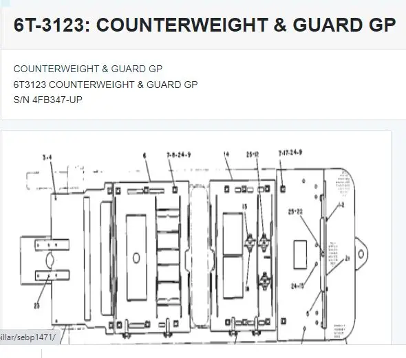

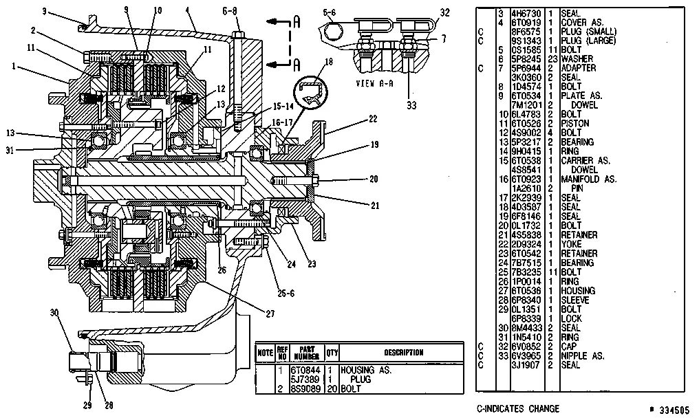

clutch and counter wieghts [attachment=71908]c334505.png[/attachment] [attachment=71909]Capture.JPG[/attachment]

Yes, just the two-speed clutch in the diagram that Bruce posted, in the driveline. It did have other different parts not in the driveline, such as the counterweight that he posted that sits under the radiator, four hydraulic outlets on the rear with the four levers in the cab on the operator's right hand side, the clutch control also on the right which was a u-shape similar to the main transmission control, where left-to-right changed the speed from direct to under, and then backwards feathered the clutch into engagement. It also had a tachometer mounted above the dash, and a set of headlights up front in addition to the usual set of field lights.
