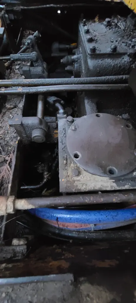

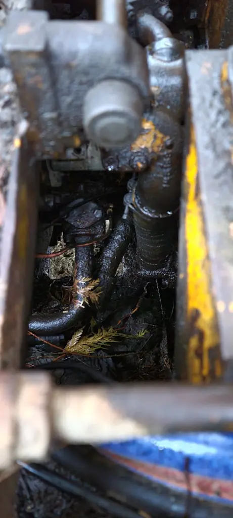

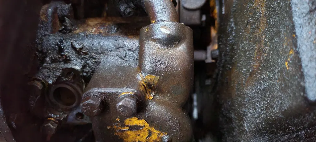

Plowing snow today I blew a hose and had a loss of drive .. I've looked through the parts manual and spoke with finning direct and we are stumped the hose I blew goes from what looks like a pump at the top of the torque converter housing to a oil filter under the left foot floor plate the second hose that is nearing end of life goes from the filter to the top front of transmission ??? Yes I can take the hoses to finnings hose shop but the reason they blew is because of the poor routing the hoses looked newish
Was hoping to find factory replacement .

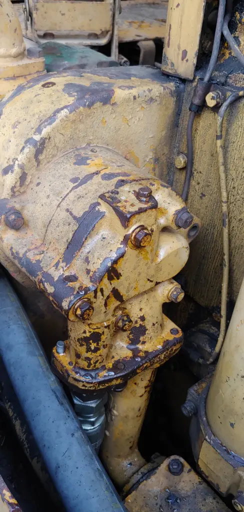

Sorry gang serial number is 17778 the pump is while sitting in the machine the filter the pump hoses go into is under the left foot and the pump is center top of torque converter . I also have the pump on the front right of the rear of engine . Finning is unable to locate the parts nor can I in both hard manuals I have

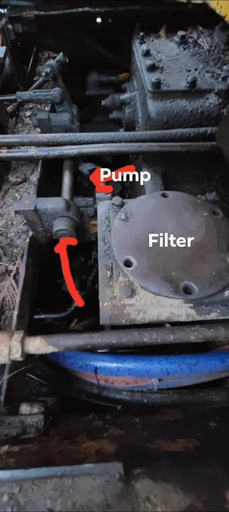

Reply to Medic235:
Possible this has both pumps ?
Second pic is the transmission and steering clutch hyd pump
Wed, Jan 6, 2021 9:38 AM

Would help if you provided tractor s/n but units with filter under left floorboard would be prior to 46A10725.
Hose from pump to filter is a 1S0030, hose from filter to trans is a 7M5124.
Pump is a 7M6621 gear pump, part of transmission lubrication system.
