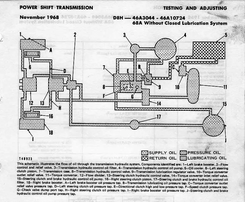

So changing out the transmission pump after testing it and finding it's only pushing 75 psi to 100 at wot . Does anyone have a flow chart on the oil it pumps ? And priming the new pump procedure. Thanks in advance

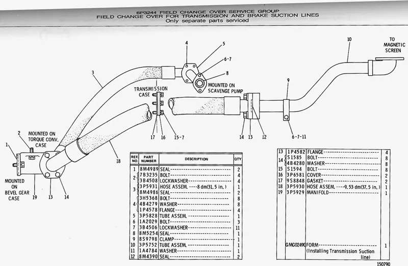

Fill pump with oil before operating, can top off using test plug. Make sure you don't have air leaks in the suction piping. Does it have the suction piping upgrade?
Thank you for your reply the serial number is d7E 6937 tahts on the cab the engine is D846A 7778 as for the pipe upgrade I am not certain. I looked for a flow chart in my manual I must have been blind .

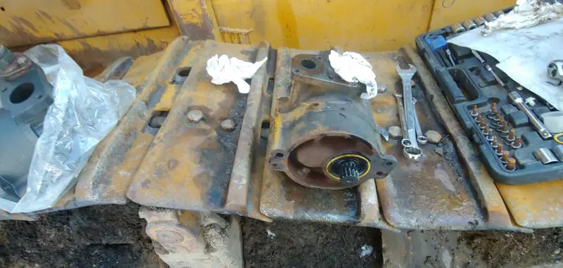

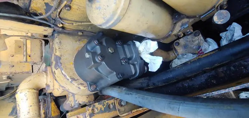

New pump installed pump shaft severally worn no wear on drive side.

The old pump internals where perfect. The only wear was the splines worn on the drive side other then the spline wear. I replaced the pump for no reason it appears .
