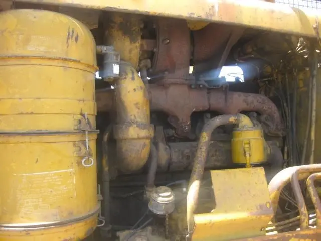

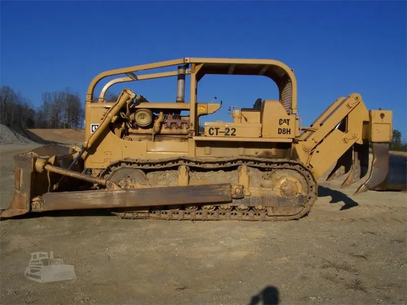

I was hoping Old Magnet or one of the other "seasoned" vetrans of this BB could give me the year and SN#'s where the D8H's went from 235 to 270 HP. Is there any easy way when looking at the machines from a distance or in a photo to tell them apart? Also where did the extra horsepower come from? Was it an RPM increase, bore & stroke change, or other? Thanks.

Provided they have the stock air cleaners it is easy to tell them apart, the 235 has a vertical air cleaner and the 270's is stuffed under the hood at an angle. Horsepower changed around 1966, OM will know exactly

Went to 270 hp in 1966 at s/n 12885-up.
FLRPM went from 1240 to 1280 rpm
Rack went from 0.270" to 0.365"
Boost went from 26 to 33 in. hg.
There were internal parts changes as well. Some day I'm going to make a list of all the part number changes.
