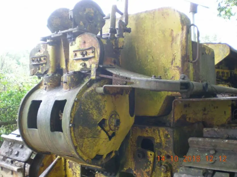

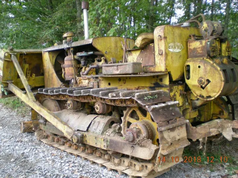

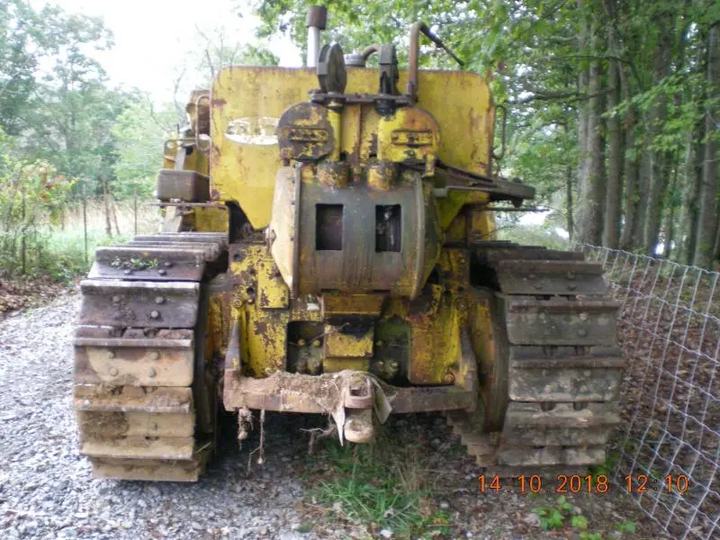

Here are some pics of the beast, stranded half in the driveway.[attachment=51056]D8 rear 14 10 18.jpg[/attachment][attachment=51057]D8 first move left side 14 10 18.jpg[/attachment][attachment=51058]D8 front 14 10 18.jpg[/attachment][attachment=51059]D8 CCU 14 10 18.jpg[/attachment]

We need more info on the steering clutches. On my old D8 the linkages were froze up. If you take the cover off and get in there with a bar you may have some success. You only need to get one to work to move it. I am impressed by your tracks. Maybe it was on Jersey box duty it's whole life.
