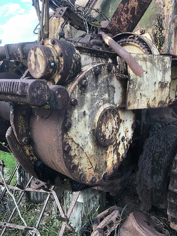

Hello All
I cannot find any identification details on my D8 15A's logging winch.
My brother says it is a McKee winch but I can't find any info about McKee Winches or even about McKee itself.
Is McKee the correct spelling? Anybody know more about them? Do they still exist under another name?
Regards
Phil
[attachment=61638]Winch 1.jpg[/attachment] [attachment=61639]Winch 2.jpg[/attachment]

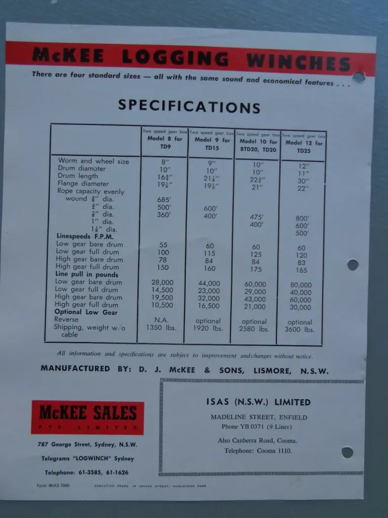

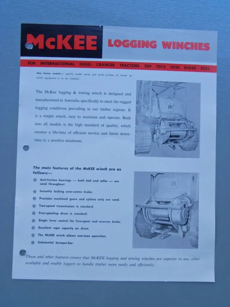

kracked1
Posts: 741
/www.ebay.com.au/itm/MCKEE-LOGGING-WINCHES-GENUINE-ORIGINAL-SALES-BROCHURE-/192841801847
Mon, Dec 28, 2020 10:13 PM

From the ebay/au site...
Thank you both. I don't know how I missed that on ebay.
Looks like McKee are long gone. Hopefully they used standard seals in them as both the winch on the D8 and the one on my D6 are leaking oil.
