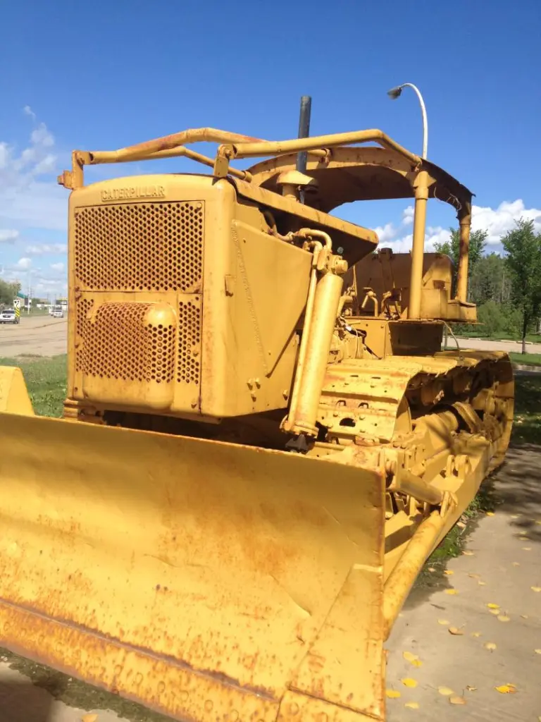

DROMONEDOG
Send a private message to DROMONEDOG
Posts: 5
Reply to DPete:
Post a photo if you can
Picture of D8
Tue, Aug 11, 2015 12:54 PM
Wombat
Donor
Posts: 1,012
Reply to DROMONEDOG:
Picture of D8
There are better brains than mine here, however I will take a guess and say it is a 1950 D8 2U and await the better knowledge to shoot me down.
Tue, Aug 11, 2015 1:43 PM
Posts: 6,850
Thank you received: 57
Reply to Wombat:
Hi, Wombat.
I'm gonna guess at 2U, 1951 or later, 'cos for it appears to have the hard nose on it.
Tue, Aug 11, 2015 2:49 PM

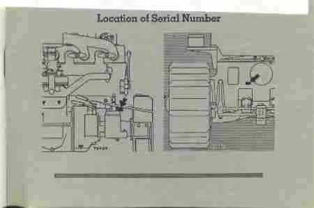

Walt D7-3T
Send a private message to Walt D7-3T
Posts: 564
Hi, Wombat.
D8 S/N Locations.
Tue, Aug 11, 2015 3:02 PM
