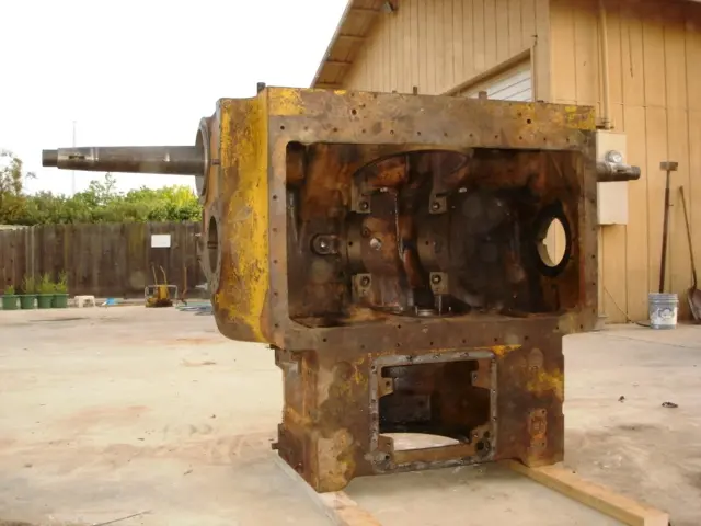

Well I finally have the main case ready for sandblasting. Its a good feeling to finally have the machine completely dismantled and ready for reassembly...

Seeing the bare bones case reminds me of a question I've had for some time so maybe now is a good time to ask.
Does anyone know what type of product, paint, glyptal or whatever Cat used as the sealer for the cast iron......that kinda mustard color yellow stuff???? on the inside of the cases.
