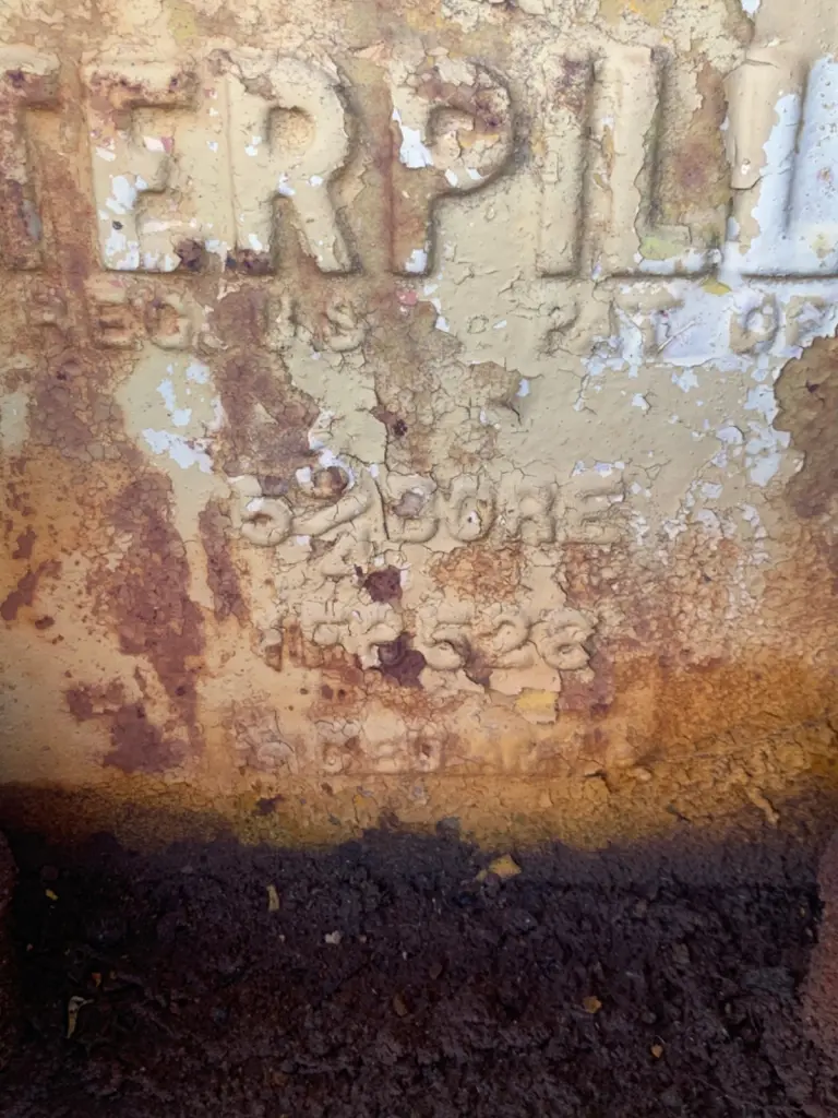

1E2528 would be a #25 Cable Control.

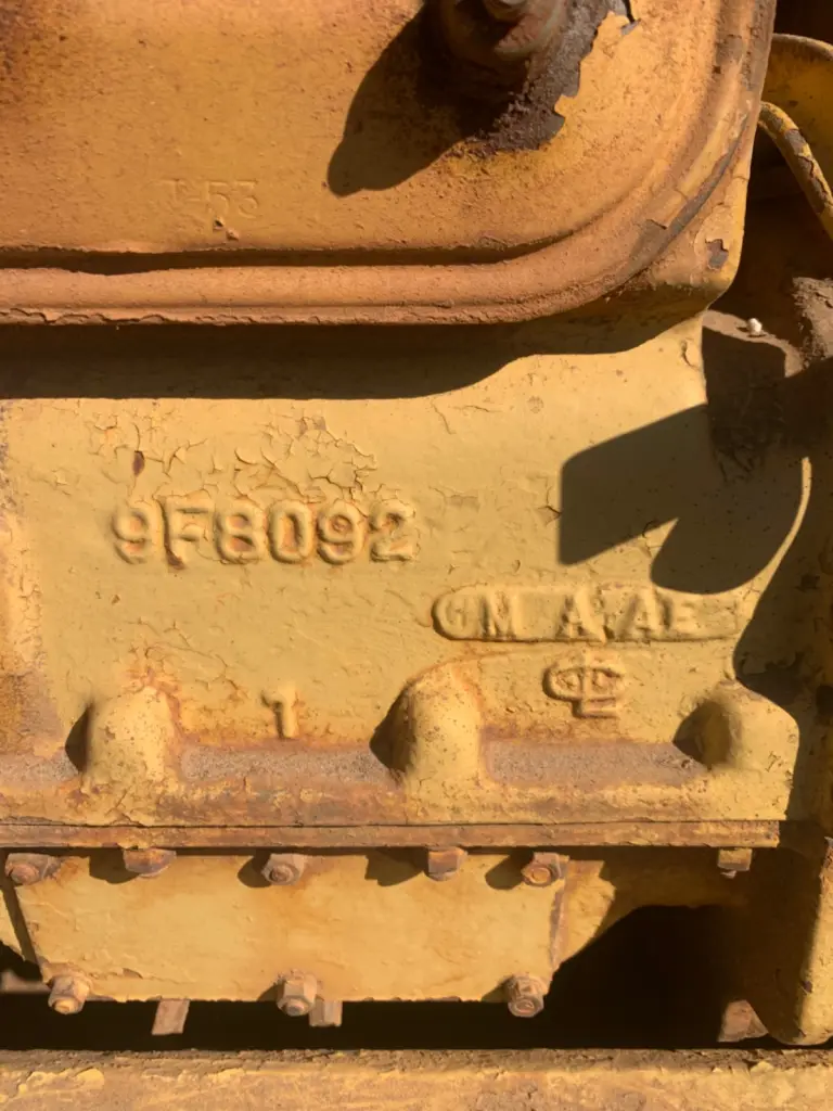

The part number on starting engine 9f8092 refer 9f8135 and fitt on D8 SERIE 13A AND D8 2U and you should have a serie tag on big blok rear the starting engine transmission

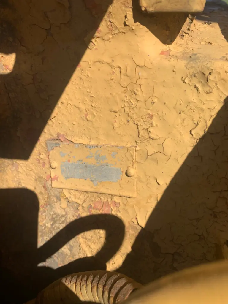

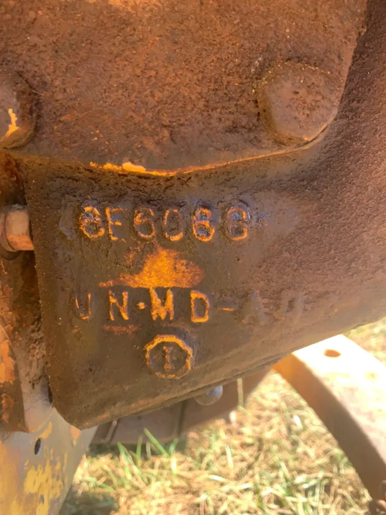

Here’s some pictures I’ve taken of the d8 and the serial numbers I’ve found.
Thu, Oct 28, 2021 7:04 PM

holding the cable control lever in to keep the blade up will just overheat the clutch plates and cause excessive wear. if the clutch is slipping that bad you need to adjust it now and probably add a few discs to take out the slack. since the blade sinks probably the brake needs adjusting only.   very different from hydraulics.  think friction and heat. make your control movements quick and deliberate and don't slip the clutch.

All those numbers are casting numbers, not part numbers. The one tag that would identify a serial number is not legible.
6F6066 would be the casting number for a 6F6464 part number. The housing for at 9D13594 to 9D36342 serial number #25 double rear drum cable control.
