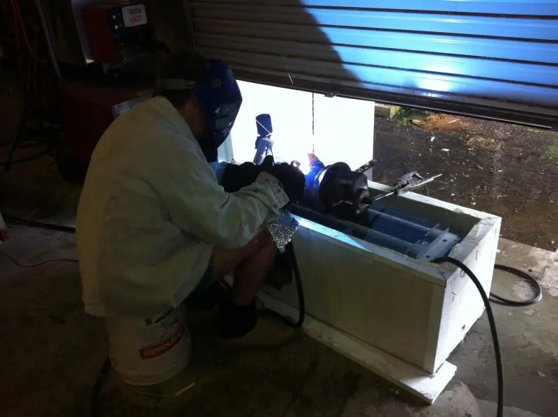

hi reclineaholic, you may want to invest in making a waterbath and a set of rollers so that you can build up the rollers without the need to
fully dissasemble them.
i used a lincoln 400 amp to do the job and just standard MS copper coated wire. yes i am sure its not ideal but i was at the end of my tether with money and figured well bugger it, I'll give it a go.
i have done about 40 hours now and cannot see the slightest bit of wear on the rollers.
ditto on welding in the lathe, though you would be able to make up a set of polyethylene soft jaws to grip the roller and effectively isolate the roller from the chuck if you wanted to.
i made a jig that would spin the roller at a constant speed while being in a water bath out of bits and pieces round the house. if you have a lathe you would be able to do the same.
my guess would be that the best rpms were about 0.7-.9 rpm for a roller that is approximately 200mm in diameter.
for earthing, i used a 15 dollar magnetic earth clamp, with a c shaped bracket i would tack welded to each roller to allow for a flat surface. worked well.
i used a windscreen wiper motor to drive one roller while the other was simply a free spinning roller.
the best beads were laid with the roller rotating away from the gun, with the gun pointing uphill, and zig zagging about a 15mm wide bead along the length of the roller. i canpretty much guaruntee you are going to be working at at least 200 amps as you need the heat to evaporate the water off otherwise the weld will sputter. i am pretty sure i was welding at around the 270-300 amp range
took a bit of learning to work out the best way, so be ready for a couple of days welding. holding the welder still and doing single line beads was pretty messy in the end, but give it a go and see what works best for you.
as with everything,theres always more then one right way.
hope this helps. : )

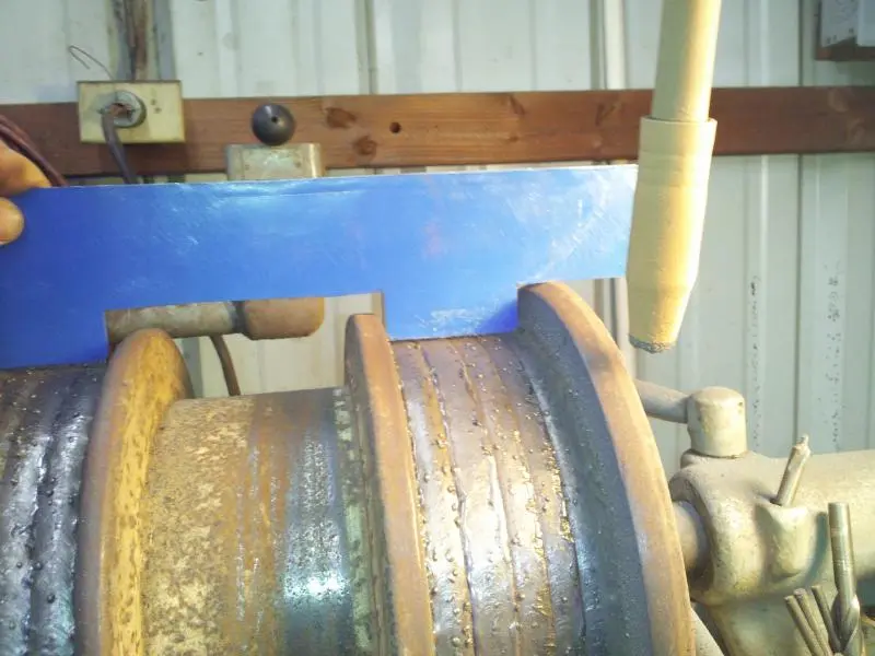

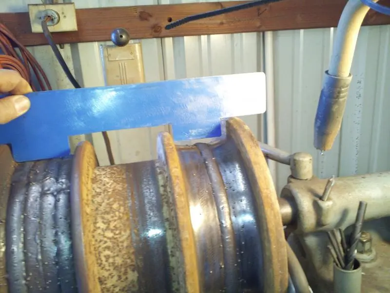

Just a follow up in case anyone else is looking for something to weld up rollers.
The Lincore 55-G hardface mig wire came yesterday and I got one of the rollers welded up with it. It was very user friendly, I just set the voltage and wire feed speed per the spec sheet and once I got the lathe speed dialed in the welds looked pretty good, they are wide, flat and smooth. There's quite a bit of splatter but don't think that will cause any problems.
[attachment=16171]2013-02-08 16.50.01.jpg[/attachment][attachment=16172]2013-02-08 20.13.56.jpg[/attachment]
i can see i'm going to have to try that.I did 2 last year for my D6 ,all by hand this looks better and should take less time.
good job!

Nice!
Have you checked the bores to see if you have any distortion?
Sat, Feb 9, 2013 1:07 PM
Posts: 3,851
Nice!
I'm not sure, but the 2nd weld looks to be flatter than the 1st?

[quote="ccjersey"]Nice!
Have you checked the bores to see if you have any distortion?[/quote]
The roller pictured needed to be built up 3/8" and had .020" shrinkage on one end and .015" on the other, it had to be bored before reassembly. I just finished another roller that only required 1/4" build up and it only shrunk about .001" I honed it with a cylinder hone and it reassembled with out a problem.
[quote="drujinin"]I'm not sure, but the 2nd weld looks to be flatter than the 1st?
Either way, nice job![/quote]
It is flatter. Thought I was getting better with practise but I've done two more and the second weld is still the best of the four so it was just lucky I guess. lol

Reply to reclineaholic:
Well done ! Wire feed cuts the time more than half . Looks to me 55 is harder than 33 .
Only draw back I see is its only recomended for 3 layers without some heating.
Much as your laying down with each pass 3 ought to be plenty.
Was it much trouble to cut out distortion?
