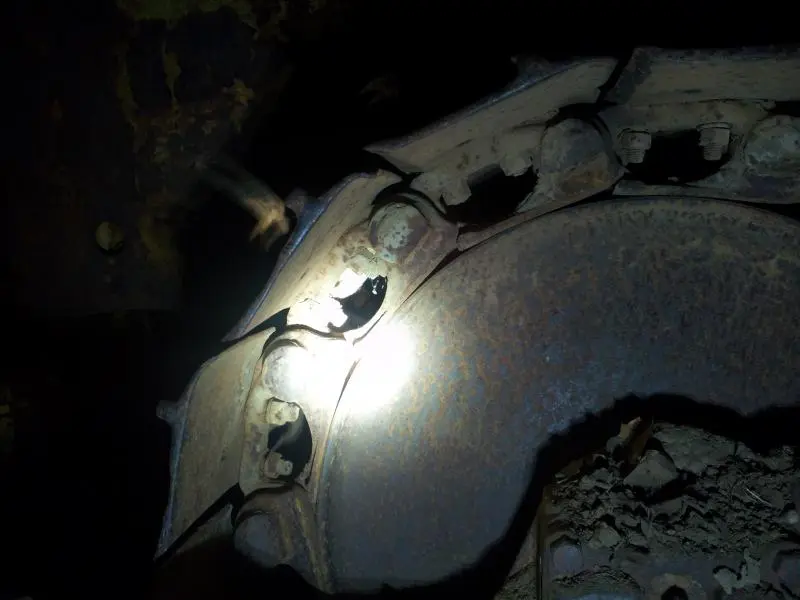

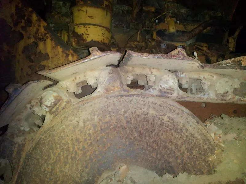

I have this old D8 2U s/n 6481, it starts and runs pretty good but I'm worried about the rails. I think they are p/n 2h953-54 if they are they should be 4.75" tall and 7.98" pitch but these are only 4" tall and 8.25" pitch. The pins and bushings don't look like they have ever been turned so I'm guessing I could turn them and fix the pitch??? But what about the rail height? The rails look like they are getting ready to break to me. I'm not looking to make this tractor perfect, just want to clear some trees, move some rocks and build a pond. The terrain is very rocky with a lot of trees.
So here's what I'm trying to decide
-Are the rails worth welding up and turning the pins and bushings?
-Or should I try to find some better used track chains? Where do look? I don't have a lot of money to invest in this old tractor.
-Or does it even make economical sense to fix it?
[attachment=16050]2013-01-27 19.57.19.jpg[/attachment][attachment=16051]2013-01-27 19.56.58.jpg[/attachment]

Boy, those are not good to put it lightly and someone has put the pads on backwards or swapped sides to try to get more wear out of the bushings. See where the bottom rollers have been hitting the pin bosses on the rails? You can cut some of the flange off of the rollers.
I think you should try to source some used ones, as someone has already run them to destruction.
You might be able to buy a complete parts tractor for what someone wants for the rails, but it depends on where you're located and how patient you are. Try Ebay, Craigslist, and here for sources.

The old spec for 2H953 & 954 was a rail height of 4.75 in. new and 4.38 in. 100% worn. Original pitch 8.00 in.
Turning bushings is something you do at 1/2 worn condition, not for recovering 100%+ worn rails.
I'm surprised your rails are even holding together in that state.
