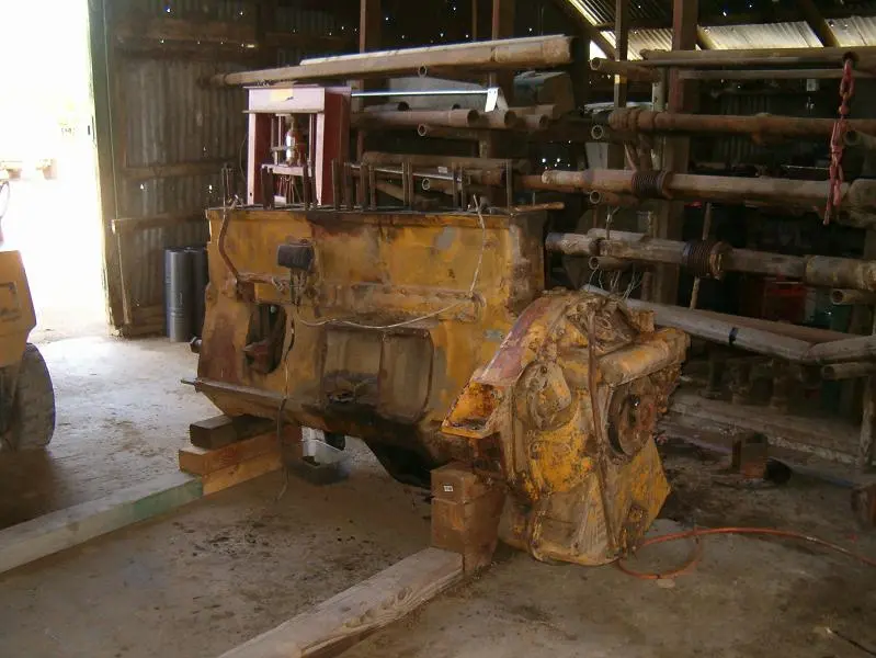

Scott, I pulled and rebuilt the engine in my D8 2U. So pulling the flywheel was easy with the block on the ground. Which I believe you have to do the same, pull it! You have to unhook your clutch fiber links, then remove the hard nose/front end. Unbolt the engine mounts from the frame rails and slid the engine forward a bit then lift up over equalizer spring cross member. Remember it weights 6,000lbs and keep track of the shims, so when you slide the engine back into place it will be centered with the clutch again.

Anybody notice something wrong in one of my pics?
You mean that "see thru" Block!!!!!
