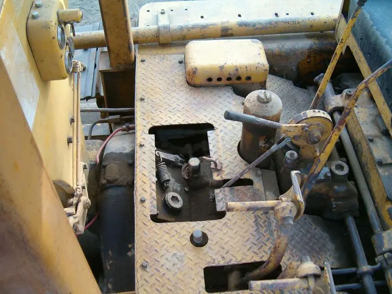

Eric, I have the links but could only find 5 but I'm sure the other one is somewhere. I will trade you the links for a 2U23,000 oil clutch cover and the left side CCU unit lever.
Attached are some pics of the links and oil clutch floor board.
