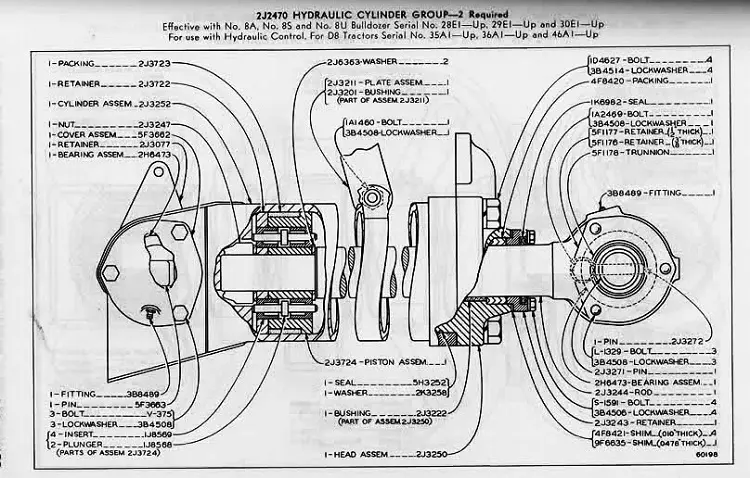

These are the lift cylinders for the 15A. Is that what you have?
Info on the cylinders would be found in the Blade parts book and Service Manual for the 183 Hydraulic Control.
 [attachment=65105]D8 15A Early Dozer Cylinders.jpg[/attachment]

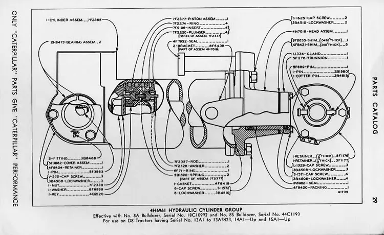

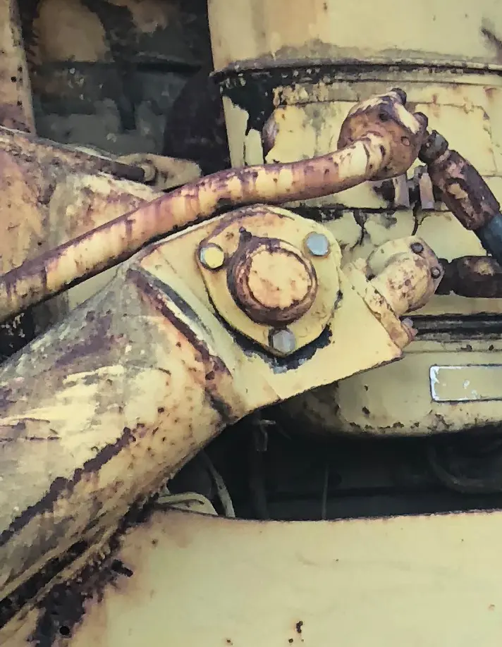

I have the parts book for the 176 and 183 hydraulic controls UE033987 and it does not show any details about the cylinder nor the framework on the dozer. I think the reason for this is the hydraulic controls are for a D8H. Do you know what form number would cover the 15A1254?
The cylinder shown in your picture is similar but not the same.
[attachment=65111]Blade Cyl.jpg[/attachment]

The parts diagram I posted is for the 15A.
Here's the diagram for the early D8H ( later units are trunnion mount)
From Parts Book Form # UE034469
 [attachment=65113]D8H Early Lift Cylinders.jpg[/attachment]

The 15A (early) Cylinder Bracket Group is in Bulldozer parts book Form #31612
The D8H (early) Bracket Group is in Bulldozer parts book Form  # UE034469
