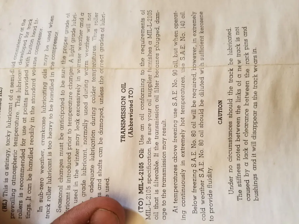

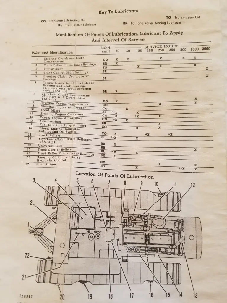

Just bought my first D8 #9A1872.
I was looking to fully service the unit before I try it out, possibly purchasing oils in bulk 45gal drums. I have some equipment that calls for 15-40 in hydraulic systems. Does any one have any input on an an alternative to cats 30w transmission drive oil in a 14A?

Cat TDTO equivalents:
Chevron.....Drive Train Fluid HD
Mobil Trans HD Series
Shell..... Spirax S4 CK

Thank you but I'm still a bit stumped. I dont see the drive train fluid in an S.A.E.#90 like recommended.
Is cats mil-l-2105 a modern GL-5 gear lube?
It just seems kinda thick to pump through filter element.

The heaviest TDTO is SAE 50
yes, GL5 is equivalent to the old 90wt gear oil.
[attachment=60677]TDTO #2.pdf[/attachment]
