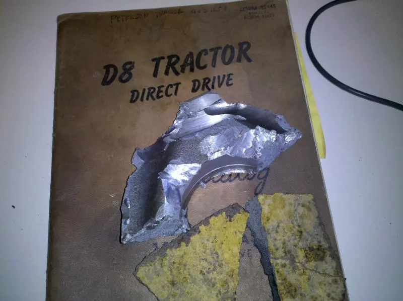

I'm going to try a pic. These are the pieces of the block and the piston. All where laying in the dirt outside the push arm!

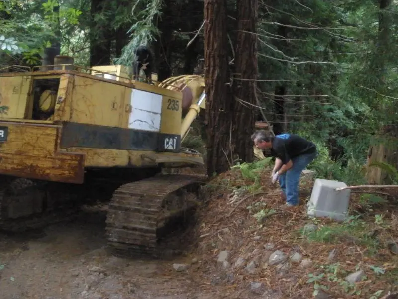

So plan B. Pull it up with the 235 excavator. That didn't work either. We bought this 235 with no stick or bucket and haven't found one yet, so all we had was the pull of the tracks... very snaky tracks.

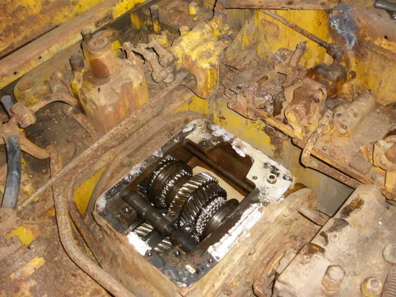

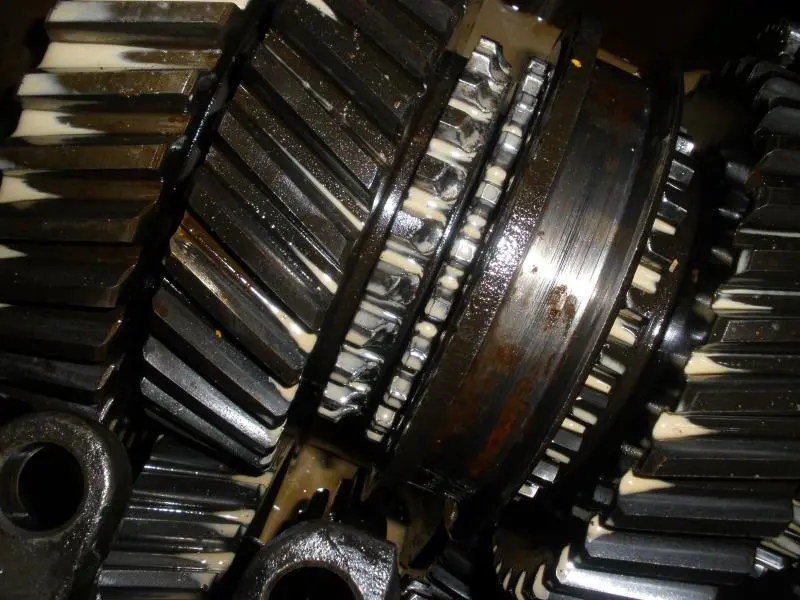

Plan C. Tear the deck and top of tranny on D8 #2 to see if it is fixable. It looks like the shift fork has worn down to about half thickness and wore about half the dogs off reverse. Now my plan is to build up the shift fork to get full engagement and give her a go.

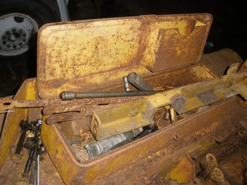

One cool discovery was the tool box in fine shape including the holder for the operators manual.

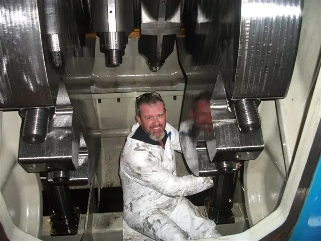

Thought I'd add a pic of me hard at work in the new power plant (PG&E). I'm lowering a main bearing for a 100 hour inspection. The con rods are above my head and crank counter weights next to me. Makes the ol' D8 seem small.
These are V18 natural gas diesel engines. 23,000 HP and we have 10 to keep running with a crew of 4!

V18 Natural Gas 23000hp
Who is the manufacturer and what is the rpm, model number??
